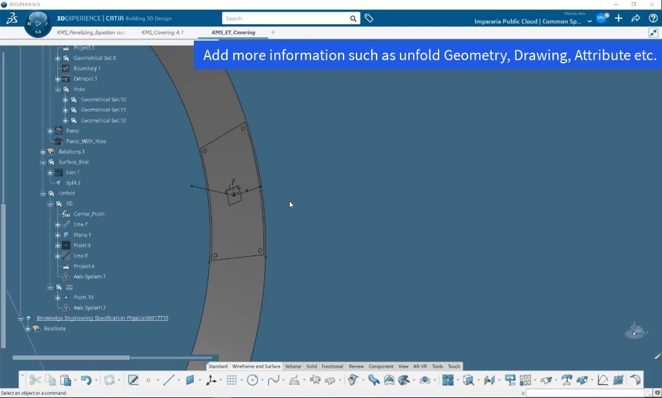

What is a Component-Based Design modeling method?
This method allows the user to Create Automation without Script. and able to switch from a simple template to a detailed template.
1, Create a Simple Template (UDF) and Detail Template( Engineering)
2, Create Object Type and Assign Templates
3, Create Pattern with "Capture Component Specification"
4, "Change Level of Development" allows the user to change a simple Template to a Detail Template
