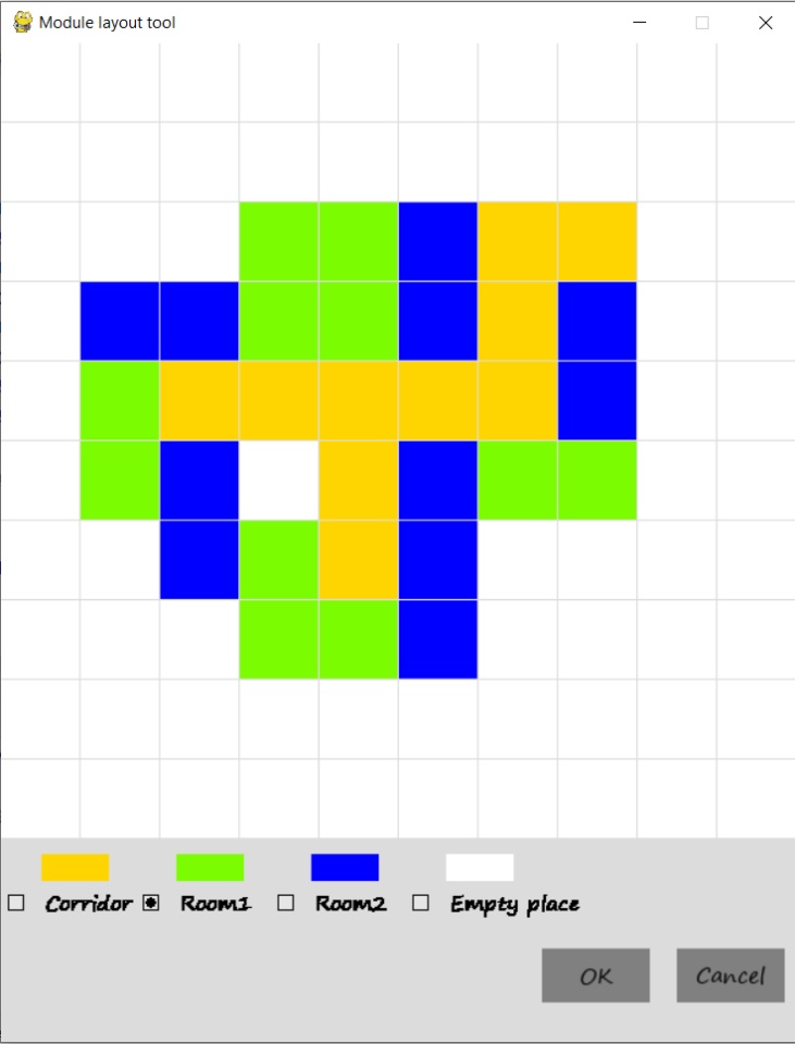

I did a bit of study on python scripting. So, today's content is a module template using Python. First of all, there is a modular plane design game made using Pythgame which is one of the Python libraries.

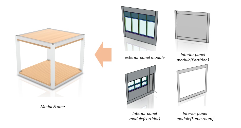

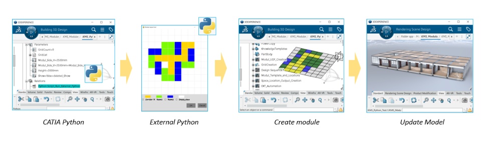

The information created here is imported into CATIA using the Python script inherent in CATIA, the module plane is recreated, and then the CATIA Automation Templates are automatically executed. CATIA Template contains the contents of arranging the module frame, analyzing the location of each space, and inserting the appropriate wall module type.

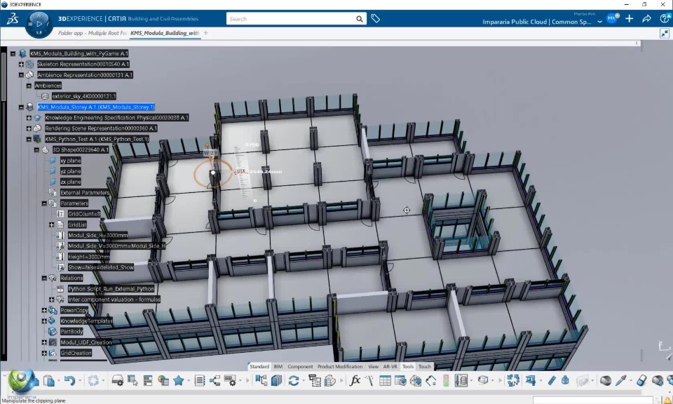

The CATIA model was created in this way (as many of you already know, CATIA models created with a top-down modeling process) can update each detail as well as the size of the module at any time by variable values.
