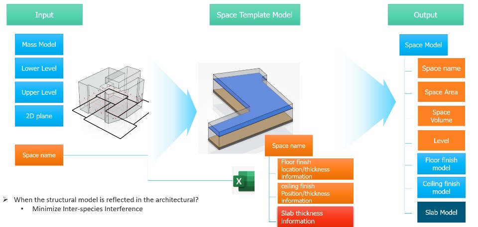

We have prepared a mass model, upper and lower floor levels, and a 2D sketch so that you can grasp the location and shape of the space as input of the template.
(image1)

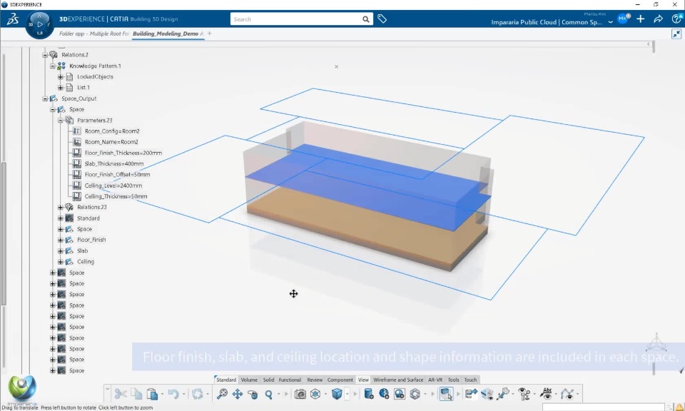

There is one template in this case, and this Template is linked to the location and thickness of each member entered in Excel which is anytime able to update, by the name of each space.
In this model, slab information is entered together at the bottom of the floor finish, and it is always moved along with the floor finish, So by design, indirection doesn't happen. The slab made in this way will be the input to the next process such as the detailed slab process, and the Beam structure design process. You can imagine that a change in the slab automatically updates the beams or details below it.
(video)
