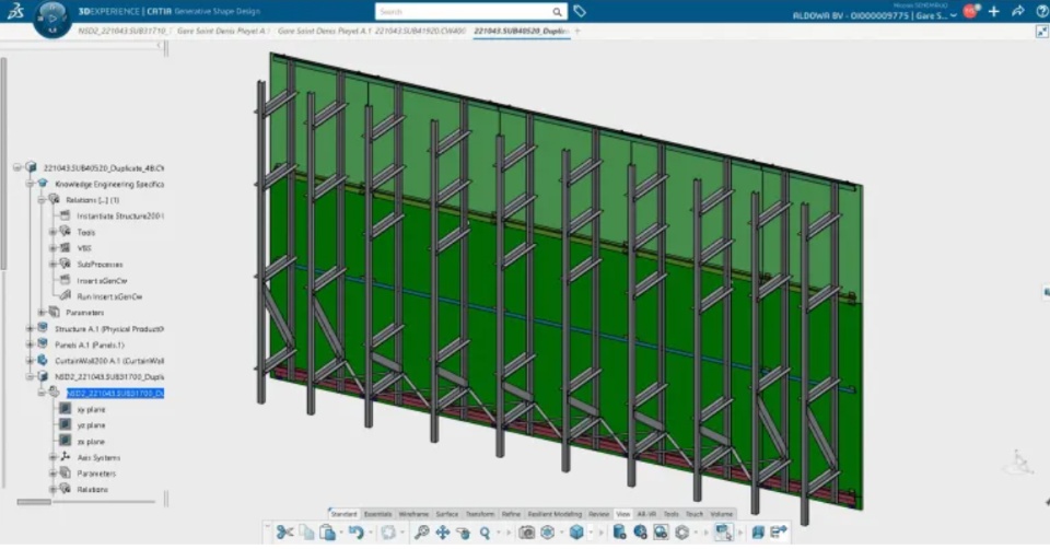

As soon as Aldowa took on Saint-Denis Pleyel, it knew it needed to find more efficient and flexible ways of working. The company had to deliver a full building model, manufacture all the facade panels and install them well ahead of the 2024 Olympic deadline. That, combined with the scale of the project, encouraged it to develop a generative design tool that could automatically create the structure and associated fixing system for almost 6,000 facade panels, of which 1,000 are unique, and handle any design changes as efficiently as possible.
“We already felt for some of our projects that their innate complexity and degree of repetition required us to work in a different way,” Van Hattum said. “This project was the perfect opportunity to apply a more automated approach.”
Aldowa was already a long-term user of Dassault Systèmes’ SOLIDWORKS design software, which provided all the capabilities it needed for the projects it had worked on over the years. Building on this, the company looked into the possibility of using the 3DEXPERIENCE platform and realized it would be an ideal fit.
“CATIA has long been used by architects to create amazing buildings, but I never considered it an option for us before because I thought the transition would be too complicated,” Van Hattum said. “The thing that made the difference was the 3DEXPERIENCE platform on cloud. It allowed us to continue using SOLIDWORKS and switch to 3DEXPERIENCE CATIA when necessary for more advanced facade projects like Saint-Denis Pleyel that required a greater level of automation. All data is compatible and accessible in the same environment.”
For this project, Aldowa partnered with the CATIA Hub, a team of design experts at Dassault Systèmes in Canada, to put in place a new methodology based on a productization concept. The aim was to develop generative facade modules that included facade knowledge and know how within CATIA, making it possible to automatically design parametric panel models and all related assembly and fabrication drawings.
Aldowa is using 3DEXPERIENCE CATIA to design almost 6,000 facade panels in an automated way.
Over the following months, the Dassault Systèmes and Aldowa teams worked closely together on the solution. This Outcome-Based Engagement approach involved developing the software to generate the panels and building structure with ongoing consultations and support to ensure it met Aldowa’s needs. The resulting feature in CATIA allows Aldowa engineers to select the walls they want to generate, define the type of wall, calculate the geometries and automatically apply the associated structural elements according to the panel’s location within the station. Functionalities were also added to give users the flexibility to add and modify certain elements such as rails or fasteners without designing each panel from scratch.
