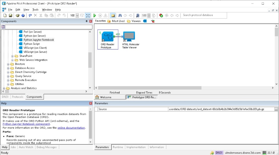

But the first two points are also easily automated. Indeed, here is a prototype ORD Reader component, which downloads the (binary) dataset from the ORD and converts it, using the Python Jupyter Notebook component now in Pipeline Pilot (together with the ord-schema Python API):

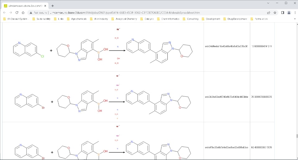

And here are the resulting records:
