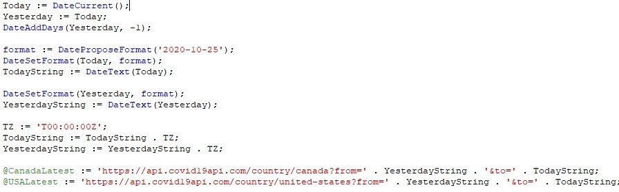

Sometimes the Source is a more complex string that needs to be evaluated at runtime. In this case, a PilotScript component is needed to build the Source string:
 Source = @USALatest

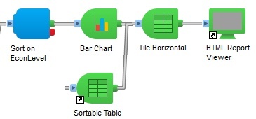

  • Sort the data on EconLevel
  • Send it to a Bar Chart report
  • Tile it horizontally with a Sortable Table from another branch (chart and table on the same row)
  • View it in a browser page
