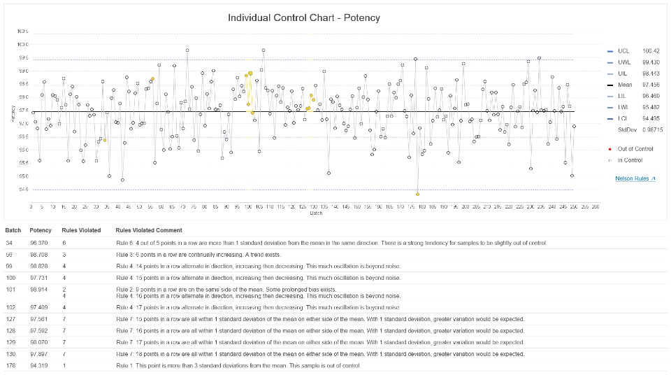

Created: 01/2023
Purpose: Filters and labels records if they violate Nelson Rules
For each incoming data record, the property mentioned in Property Name is evaluated. If any Nelson Rule is violated, the record is sent out the Fail port, together with added associated properties Rules Violated and Rules Violated Comment.

The rules are applied to a control chart on which the magnitude of some variable is plotted against time. The rules are based on the mean value and the standard deviation of the samples.
  • Rule 1: One point is more than 3 standard deviations from the mean. One sample (two shown in this case) is grossly out of control.
  • Rule 2: Nine (or more) points in a row are on the same side of the mean. Some prolonged bias exists.
  • Rule 3: Six (or more) points in a row are continually increasing (or decreasing). A trend exists.
  • Rule 4: Fourteen (or more) points in a row alternate in direction, increasing then decreasing. This much oscillation is beyond noise. Note that the rule is concerned with directionality only. The position of the mean and the size of the standard deviation have no bearing.
  • Rule 5: Two (or three) out of three points in a row are more than 2 standard deviations from the mean in the same direction. There is a medium tendency for samples to be mediumly out of control. The side of the mean for the third point is unspecified.
  • Rule 6: Four (or five) out of five points in a row are more than 1 standard deviation from the mean in the same direction. There is a strong tendency for samples to be slightly out of control. The side of the mean for the fifth point is unspecified.
  • Rule 7: Fifteen points in a row are all within 1 standard deviation of the mean on either side of the mean. With 1 standard deviation, greater variation would be expected.
  • Rule 8: Eight points in a row exist, but none within 1 standard deviation of the mean, and the points are in both directions from the mean. Jumping from above to below while missing the first standard deviation band is rarely random.

  • Nelson Rules Filter example: This example protocol generates 100 batch potency values at random, following a normal distribution. The Nelson Rules Filter is used here to determine whether potency is out of control (unpredictable versus consistent).
