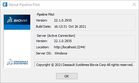

Version affected:
Pipeline Pilot client
If you are using the Pipeline Pilot client, you can obtain the Pipeline Pilot version from the Help menu > “About Pipeline Pilot
The resulting window compiles the client version, and build date as well as Server version, Server location (URL) and Server OS.
That information is required when filling a case, and help BIOVIA Support to focus our investigation.

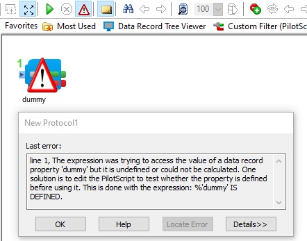

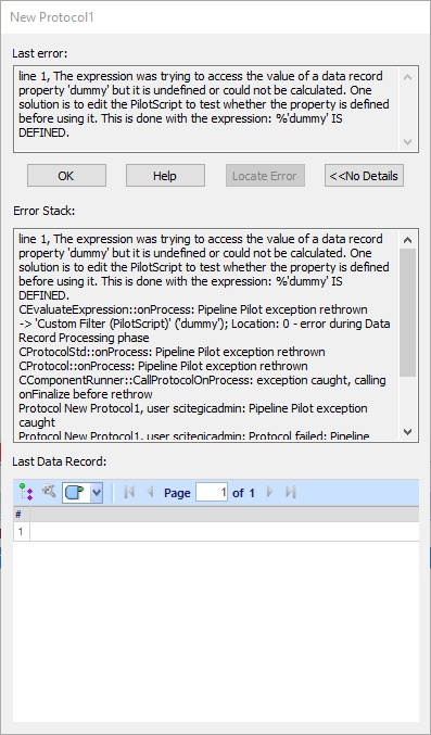

Full Error Stack messages
When the error appears as result of a client execution, a warning sign is displayed on the component failing and some additional information on the failure.
Selecting “Details >>”, will display the full error stack. In most of the case, the information provided help to address the issue.
This text can be copied and pasted as plain text. Attach the resulting text content of the section “Error Stack” to the case report. Avoid, when possible, screenshot of the error message.
