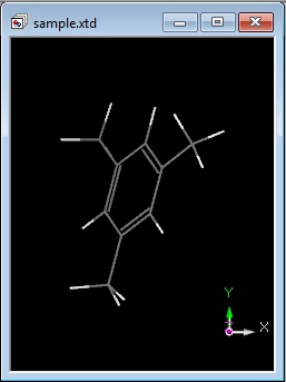

A .sdf file can contain multiple structures. When imported into MS (Materials Studio), the structures are collected into a single “trajectory” (.xtd) file. The attached example .sdf file (sample.sdf) appears similar to the following screenshot when imported into MS:

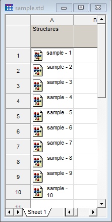

The trajectory document, sample.xtd, contains all the 10 structures from the sample.sdf file. One may separate the structures into individual cells in a study table, using the “Insert From File” utility to insert sample.xtd, resulting in a study table similar to the following:

And then if you want to quickly get individual XSD's, you can select the structures in the study table, right-click and select Extract To Collection. In the resulting collection document (.xod), right-click and select Extract to Atomistic Documents. This should create new documents containing the individual structures - much easier than using copy/paste multiple times! This can be used for any trajectory but is generally suitable for smaller systems, otherwise creating the collection document can take too much time/memory.
