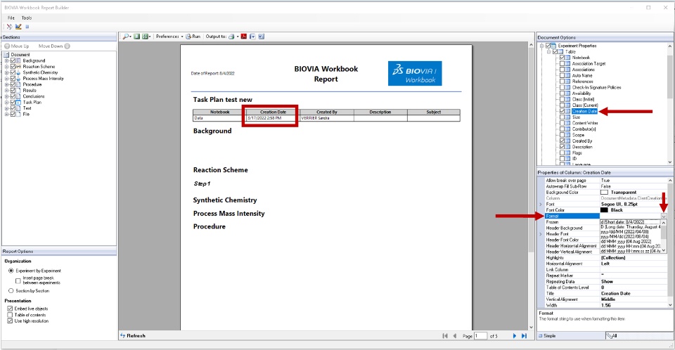

Workbook report date format
Some sites require BIOVIA Onelab to support consistent date/timestamp structure in keeping with Good Documentation Practice. Workbook report Creation Date is mm/dd/yyyy hh:mm AM/PM by default, but this can easily be changed:
1. Run Experiment Report opens the BIOVIA Workbook Report Builder as a print preview.
2. Shift-click the date format you want to change, verify it is selected in Document Options.
3. In Properties select Format and click the blank field to enable the dropdown arrow.

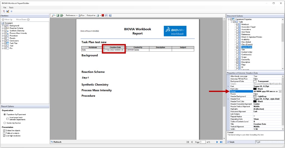

4. Click the dropdown arrow to select a format i.e. dd MMM yyyy HH:mm:ss zz
Report Builder will keep this setting for future reports until you change it or click Clear Changes icon (top left) to revert to default report settings.
