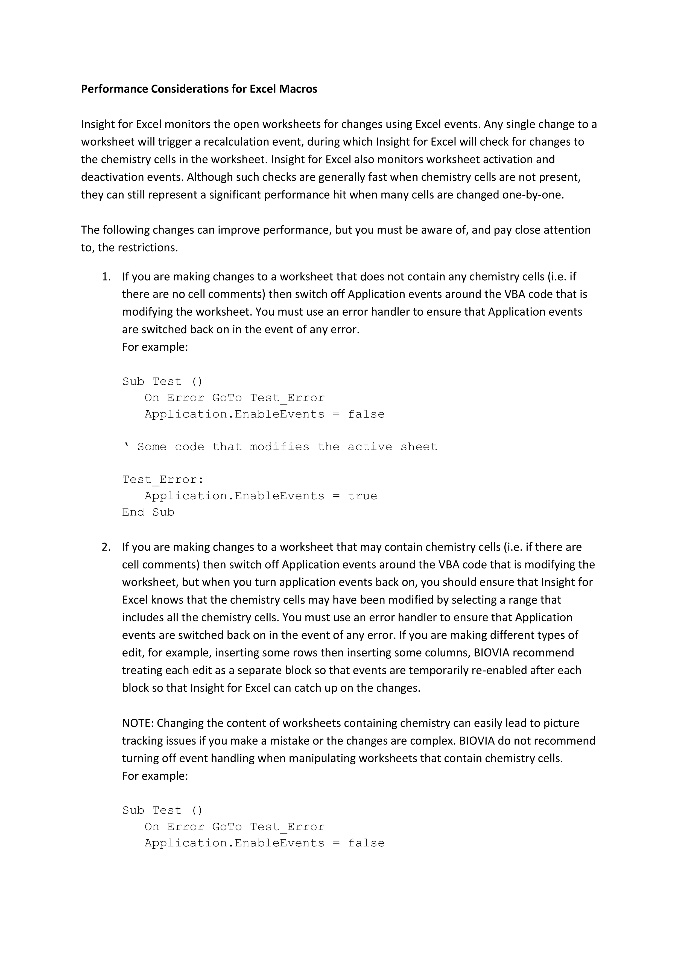

Insight for Excel: Performance Considerations for Excel Macros
The attached document describes a couple of things to consider when using an Excel VBA macro with Insight for Excel.
