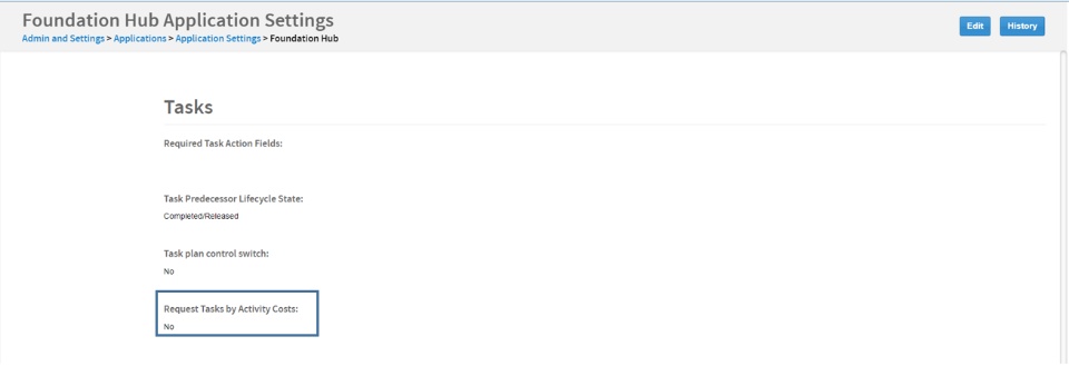

To do this an option must be turned on in the application settings. This can be found under the Admin & Settings > Applications > Application Settings > Foundation Hub. The option is under the Task section of the Foundation settings and its called "Request Task from Activity Costs"

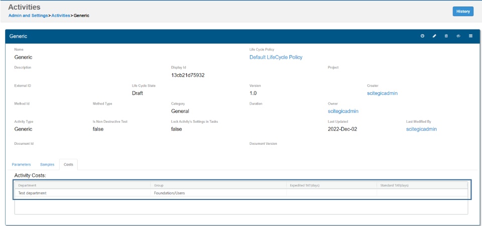

Once this option has been enabled now a group(s) must be added to an Activity in the Activity Costs. Se the example below:
After this when hitting the Request button in the Tasks tab of Task Plan it will only show the groups under the activity costs.
