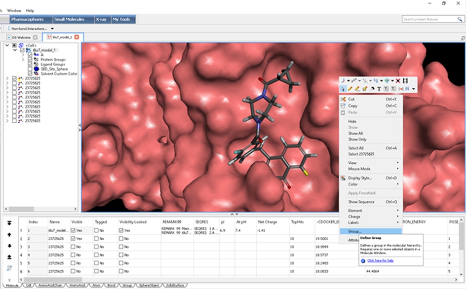

  • The protein-ligand complex was obtained by docking Olaparib to SARS-CoV-2 main protease using CDOCKER.
  • Select H52 (the hydrogen in position 8 in the isoquinolinone ring) and create a group. To create a group right-click on the Molecule Window and click on Group… If you want to include other growing points, you should select all the growing points (Shift+left-click) before the group creation.

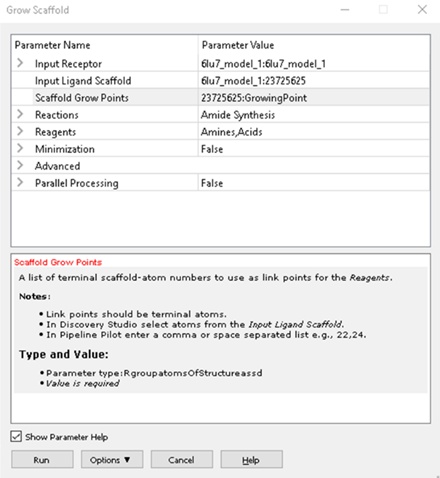

  • Open the Grow Scaffold… protocol located in Receptor-Ligand Interactions > Lead Optimization tool panel.
  • In the Parameter Explorer make sure the receptor (6lu7) and ligand (Olaparib) are correctly chosen as the Input Receptor and Input Ligand Scaffold, respectively.
  • Next specify the Scaffold Growing point. From the drop-down menu select the group created in step 2.
  • You may want to adjust the other parameters, but for this example the defaults were used to reduce the computational cost. Two of the most important parameters to obtain a diverse set of ligands, is to modify the Reactions and Reagents parameters. Discovery Studio comes with a set of 8 reactions, but custom reactions and reagents can be added.
  • Click on Run after everything has been set up.
When the protocol finishes, you should see 400 unique ligands generated (this number may vary depending on the parameters used).
