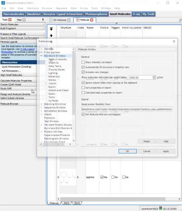

1. starting from the Data Table of your molecules, add a new column to take up the SMILES: right-click on any of the column headers and select Add Attribute with the following parameters:
add to: Molecule
Value: - leave empty -
Type: String
2. if at the left you don’t see the structures already, right-click on the index column and click Show Chemistry to display them.
3. go to Edit > Preferences… and verify that in Molecule Window the Ignore column titles option is checked.
4. click on the header of the Structure column to select it entirely and copy the contents to the clipboard (Ctrl-C or right-click > Copy).
5. select the header of the new column of step 1 and paste (Ctrl-V or right-click > Paste) the contents of the clipboard.
Done.
