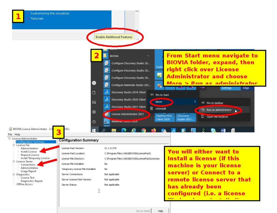

In the image to the left, 1. shows a Discovery Studio Client that has not yet been configured to communicate with a license server. That 'Enable Additional Features' message in the lower right corner of the Discovery Studio Client indicates that at present the program is operating as the free Discovery Studio Visualizer.  It's fine to use ​​​​​​​the program like this but it has limited features. Images 2. and 3.above show how to configure licensing on a Windows client.

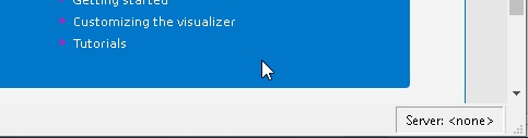

If the lower right corner of the Discovery Studio Client looks like this:
That doesn't mean that you are not connected to the license server. On the contrary, it means that you ARE! (only if the lower right shows 'Enable Additional Features' are you not connected to a license server). The "Server: " message means that you are not yet connected to a Discovery Studio/Pipeline Pilot server. If you have installed the Pipeline Pilot server locally on the client machine and used the default port numbers then you can click on that spot in the lower right corner and enter localhost:9943. If you have installed Discovery Studio/Pipeline Pilot on a remote computer then you can enter the name and port number of that remote server.
