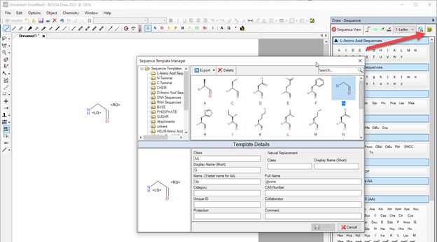

In BIOVIA Draw libraries of the various types of sequence residue templates, like amino acids, sugars, bases etc. are managed with the Sequence Template Manager”. For the drawing of new templates this is as well a good starting point, for example with the template of glycine.

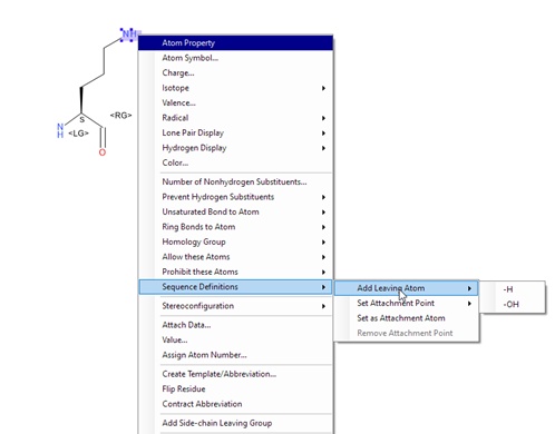

After drawing the full structure of your new template, you may place additional leaving groups in the side chain, in addition to the left and right and that are obligatory. Leaving groups enable connecting templates to each other while drawing sequences. Use the right-click menu for creating leaving groups.

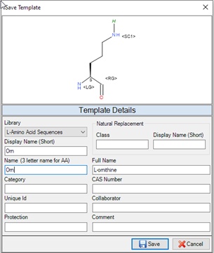

Finally, your template needs to be saved. In the File menu chose “Save as SCSR Template”. Enter additional data and save into the corresponding library.

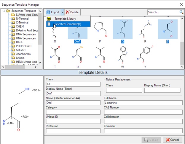

Now, in order to upload your newly created templates into a Centralized Library, you go and export your templates from the Sequence template Manager dialog.

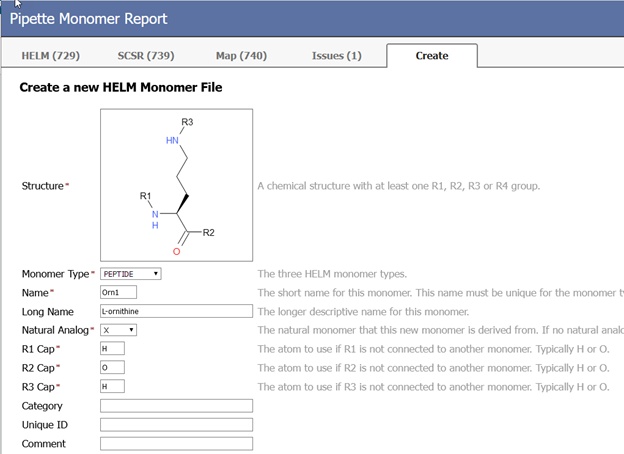

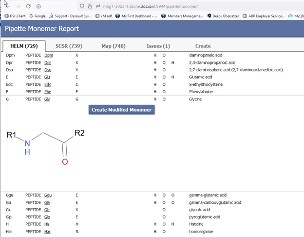

To start drawing HELM monomers, launch the Pipette Sketcher Monomer Report:
https:// server URL>/pipettemonomer/
You may start from an existing monomer:
Make your edits and export as SD file:
After merging the downloaded SD files, the resulting file can be uploaded into a Centralized Library.
