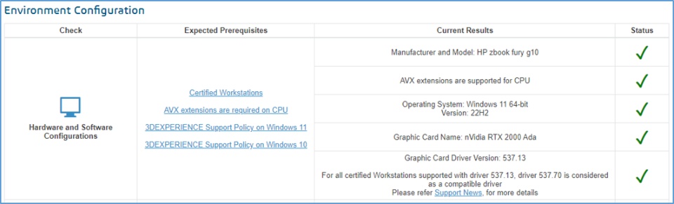

Changes in Hardware and Software Configurations:
Graphic Cards:
Graphics Card driver versions has been updated for Certified Workstations and VDI, as per below:
For all certified Workstations supported with driver 537.13 driver, driver 537.70 is considered as a compatible driver and for all certified Configurations for VDI supported with driver VGPU 16.1 (537.13 driver) driver 16.2 (537.70) is considered as a compatible driver. Please refer Support News, for more details.
List of all those certified workstations are available on Certified Workstations Webpage and list of all certified VDI are available on Certified Configurations for VDI Webpage.
Certified Workstations:
There are some new workstations, which has been certified for supporting the 3DEXPERIENCE Platform on Cloud. These workstations are updated into the Certified Workstations List. An easy access to the same has been provided in the Cloud Eligibility Tool itself by hyperlinking it in the Expected Prerequisites column for the Hardware and Software Configurations check.
For all the above changes done into HW & SW configuration, Cloud Eligibility Checker tool does take them into account, as you can see below:

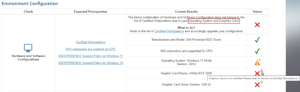

Enrichments in HW/SW combination check:
There has been few UI changes in Hardware and Software Configuration check based on the user’s feedback, for better understanding and analysis of the final result.
  1. HW/SW Combination Check: Now the combination check delivers more specific information about Hardware and Software Configuration check compared to previous one which used to display more generic information. With the new enhancement, user will now able to classify the exact HW/SW component that is causing the HW/SW combination check KO. For e.g.
                    Image 2
As shown in image 2, the HW/SW combination check is KO due to the Operating System. The Windows 11 64-bit 22H2 is a certified Operating System as per the 3DEXPERIENCE Support Policy on Windows 11, but please note that this Operating System is not certified particularly for this manufacturer and model i.e. Dell Precision 5820 Tower (please refer to the certified workstation list), and accordingly “Warning” is shown in the status column. The (i) (information) symbol on top of the Warning symbol, provides comprehensive information regarding the same as shown in image 3.
                        Image 3
Note: To see this information user needs to hover the mouse over the (i) symbol.

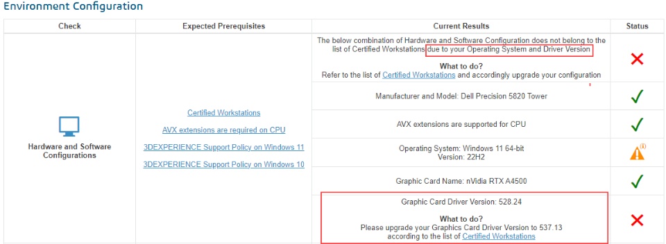

        2. The new enhancement will also identify the exact HW/SW component which needs to be upgraded or replaced. For e.g.  Please refer the image 4
                               Image 4
When tool identifies the exact HW/SW component to be upgraded, in that case explicitly “What to Do?” message is displayed for user action.

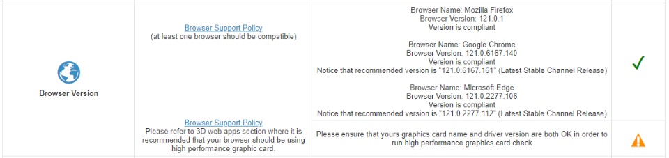

Changes in Browser Version:
As per the Platform Support Policy, for 3DEXPERIENECE Platform on cloud, the most current stable channel release of the Google Chrome and Microsoft Edge Chromium, is a Compatible Platform. For Mozilla Firefox version greater than 102esr is a validated and compatible platform. Please upgrade your browsers to the recommended channel releases as per below:
Google Chrome:
For now the most current stable channel release of the Google Chrome is Version 121.0.6167.161 Official Build for both 64-bit and for 32-bit. Stable channel are released for Google Chrome on specific time interval. Hence your browser version should be on the mentioned stable channel release to be compatible with platform. You can refer most current stable channel releases through Google API here.
Microsoft Edge Chromium:
For now the most current stable channel release of the Microsoft Edge Chromium is Version 121.0.2277.112 (Official build) (64-bit). Stable channel are released for Microsoft Edge on specific time interval. Hence your browser version should always be on the mentioned stable channel release to be compatible with platform. You can refer most current stable channel release through Edge API here.
Mozilla Firefox:
For both 64-bit Mozilla Firefox and 32-bit Mozilla Firefox 102esr is a Validated Platform. Hence your browser version should be greater than or equal to above mentioned channel release to be compatible with platform
Cloud Eligibility Checker Tool does take these changes into account, please refer below image 6,
