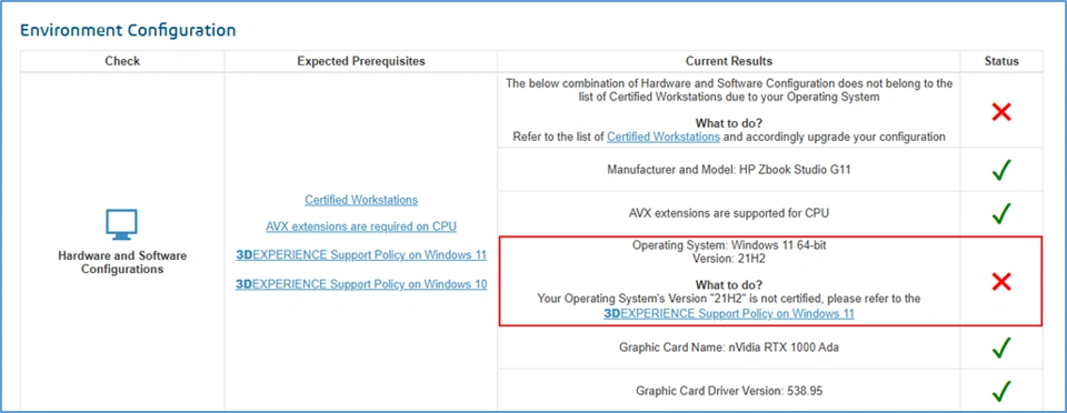

Operating System:
Windows 11 supported levels has been evolved for 3DEXPERIENCE® Platform on the Cloud. The changes are as per below:
- Windows 11 Enterprise: Supported versions are 22H2 and 23H2. Version 21H2 is no more supported.
- Windows 11 Pro: Supported versions is 23H2. Version 22H2 is no more supported.
- Windows 11 Pro for Workstations: Supported versions is 23H2. Version 22H2 is no more supported.
For more details on the same, please refer below support policies:
Cloud Eligibility Checker does take this changes into account in Hardware and Software Configurations check as per below:

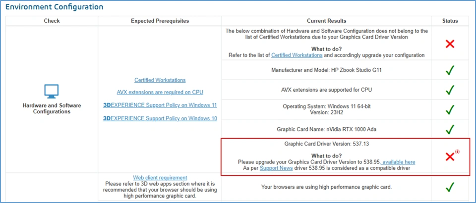

Graphic Card Driver Version:
For all certified Workstations supported with driver 537.13 or 537.70 or 538.33 or 538.49 or 538.78 driver, driver 538.95 is considered as a compatible driver.
For all certified Workstations supported with driver 551.61 or 552.74, driver 553.24 is considered as compatible driver.
For all certified Configurations for VDI supported with driver VGPU 16.1 (537.13 driver)or 16.2 (537.70 driver) or driver 16.4 (538.78 driver) or driver 16.7 (538.78) , driver 16.8 (538.95) is considered as a compatible driver.
You can also refer support news here for more details and recent updates.
Cloud Eligibility Checker does take care of these changes as per below with a link to download compatible driver version in HTML result itself:

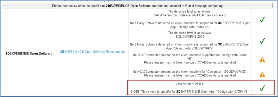

Java Version Changes:
Java Runtime and Build Time Support Policy has been evolved as documented below:
- IBM Semeru Runtime Open Edition for Java 21.0.4 (JDK) will be a Validated Platform.
- IBM Semeru Runtime Open Edition for Java 21.0.x (JDK) with x >4 will be a Compatible Platform.
- Oracle JDK 21.0.x with x>=4, will be a Compatible Platform.
Java is prerequisites as per 3DEXPERIENCE Open Software Requirements. More details can be checked and confirmed in program directory here. Cloud Eligibility Checker Tool does take care of this changes as per below:
1. When Open Software (CATIA V5 and SOLIDWORKS) installation detected:
2. When Open Software (CATIA V5 and SOLIDWORKS) installation is not detected:
