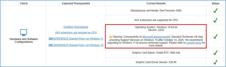

Operating System:
Consequently to Microsoft announcement, Dassault Systemes will stop providing Support Services on Windows 10 after October 14, 2025. For more details please refer notice related to support of our software products on Windows 10.
Windows 11 supported levels has been evolved for 3DEXPERIENCE Platform on the Cloud as per below:
  1. Windows 11 Enterprise: Supported versions are 22H2 and 23H2.
  2. Windows 11 Pro: Supported versions is 23H2.
  3. Windows 11 Pro for Workstations: Supported versions is 23H2.
Similarly, Windows 10 supported levels for 3DEXPERIENCE Platform on the Cloud as per below:
  1. Windows 10 Enterprise: Supported versions are 21H2 and 22H2.
  2. Windows 10 Pro: Supported versions is 22H2.
  3. Windows 10 Pro for Workstations: Supported versions is 22H2.

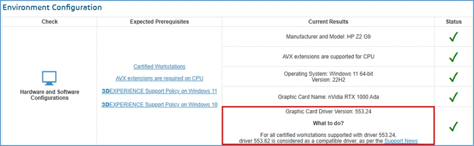

Graphic Card Driver Version:
  1. For all certified Workstations supported with driver 538.78, driver 539.19 is considered as a compatible driver.
  2. For all certified Workstations supported with driver 553.24, driver 553.62 is considered as compatible driver.

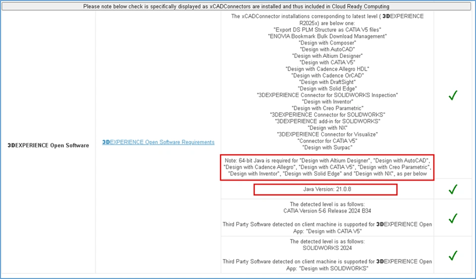

Changes in 3DEXPERIENCE Open Software Check and Java Version Check:
Considering the dependency of xCAD Connector on java version, the 3DEXPERIENCE Open Software Check has been evolved with xCAD Connector installations and java version check. This will be computed in Cloud Ready Computing, i.e. Global Status of Final HTML report.
If Java is required for installed xCAD Connectors, as per the Program Directory specifications then a separate note will specify those details and the java version check will be displayed below the xCAD Connector check:

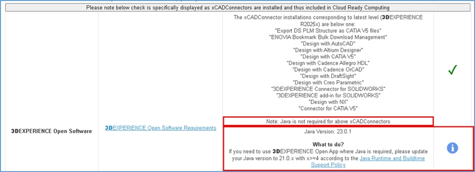

If none of the installed xCAD Connectors requires java then note will specify that detail and java version check will be displayed only for information:
