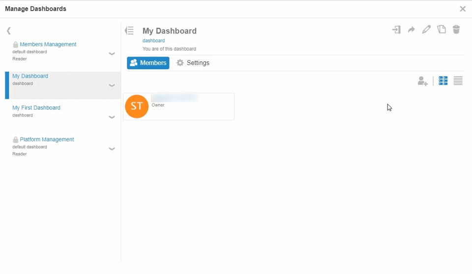

  • Share your dashboards to groups
You can share a dashboard to a group of people. This will help you duplicate your community or 3DDrive audience in your dashboard, so that you don't lose time adding all the users one by one.​​​​​​​
