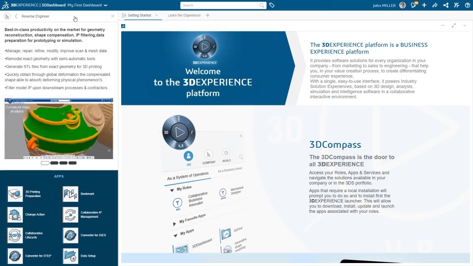

The Compass evolves in R2021x to not only give you access to your Roles & Apps, but also to let you navigate the entire 3DS Solutions portfolio.
The compass becomes the place to discover, understand and even preview these solutions in a very comprehensive way, always available and up to date. It gives you the opportunity to discover values you could benefit from in your job and more generally in your company business.
We also took this opportunity to update the overall experience with streamlined access to Apps and a global UI refresh.
Let’s take a closer look on what’s new :
The Compass now works as a single button. The first level of navigation has 3 sections :

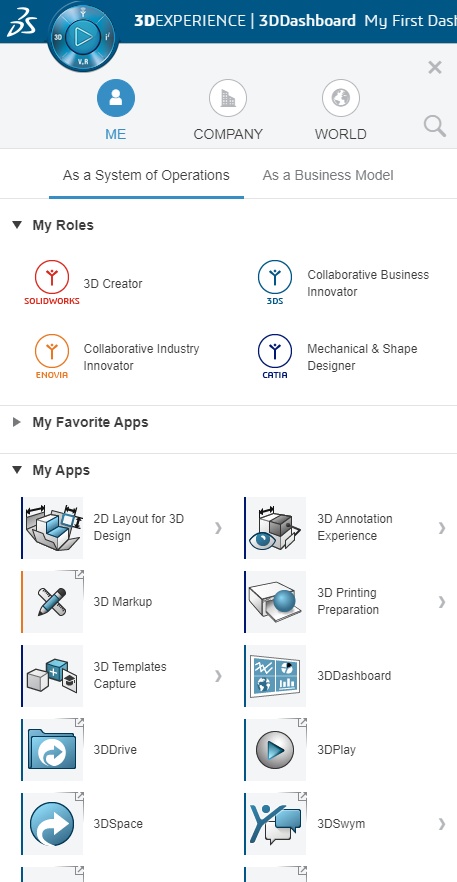

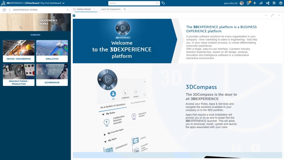

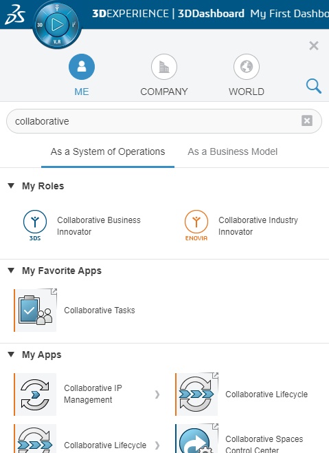

ME : Your Roles & Apps
VIDEO: ME - Your Roles & Apps

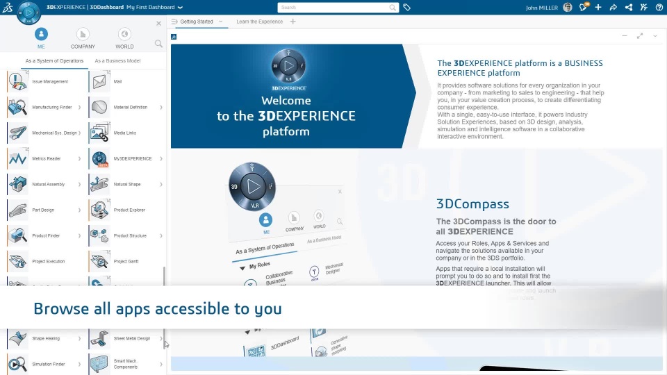

In As a System of Operations, you find your Roles and Apps in a very similar fashion as in previous versions:
  • My Roles section reveals the roles granted to you. Click on a Role to see the related Apps and to discover its values. New Role icons reveal the related Brand, for a quick identification of their domain of activity:
  • My Favorite Apps still allows you to quickly access the apps you add there. Simply drag & drop your apps to add, reorder or remove them from this section.
  • My Apps section now shows all the apps you have access to in one single list, no more sorted by compass quadrant. A lighter icon style improves the readability of the app symbols.
  • Search now works for Roles & Apps at the same time
  • Finally, the possibility to activate or deactivate Roles has been removed
Your custom roles & apps are still shown there.

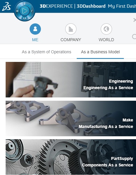

In As a Business Model, access the Trading Experiences and their qualified ecosystems of industrial service providers: MAKE for on demand manufacturing, PART SUPPLY for on demand component sourcing and ENGINEERING for on demand engineering service.

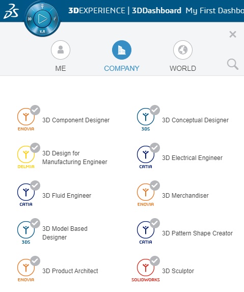

COMPANY : Roles available in your platform
VIDEO: COMPANY - Roles available in your platform
Discover the roles available on your platform. Learn more about the value they bring with a description, videos and images. Should you need one of them, simply request it in one click.
Discover the roles available on your platform. Learn more about their value with a description, videos and images. Should you need one of them, simply request it in one click.

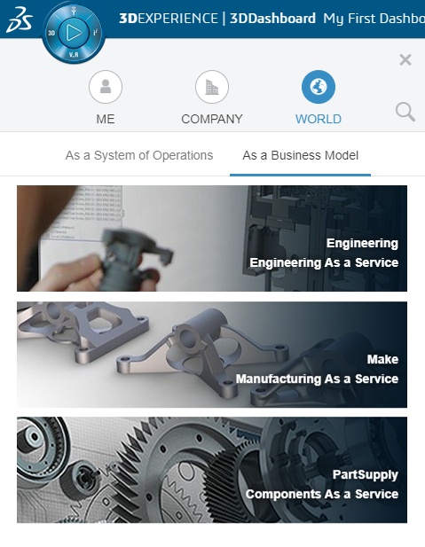

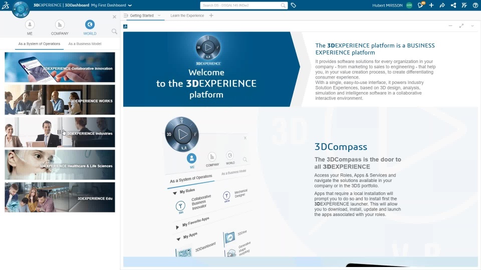

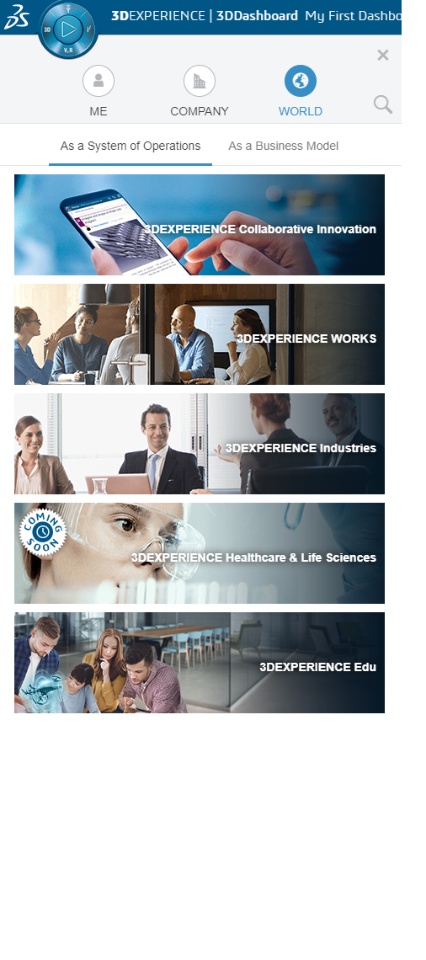

WORLD : Navigate 3DS Solutions Portfolio
VIDEO: WORLD - Navigate 3DS Solutions Portfolio
In As a System of Operations, discover the solutions serving the industry in 5 universes:
  • 3DEXPERIENCE COLLABORATIVE INNOVATION with roles that can be used by everyone in a full Software as a Service (SaaS) offering.
  • 3DEXPERIENCE WORKS to empower users all along the value stream, from upstream thinking to sales & marketing with roles structured by domains.
  • 3DEXPERIENCE Industry with a portfolio of Industry Solution Experiences, Industry Process Experiences and Roles to help companies of address their industry challenges & create unique innovation for their customers.
  • 3DEXPERIENCE Healthcare & Life Sciences dedicated to Industry Solution Experiences, Industry Process and Roles of this sector – Coming Soon
  • 3DEXPERIENCE EDU with learning experiences targeting the Workforce of the future in Companies, Professionals, Academics and Students ecosystems.
In As a Business Model, new categories of Experiences serve any persons in their business environment. The first Universe available here is related to Trading Experiences with MAKE for on demand manufacturing, PART SUPPLY for on demand component sourcing and ENGINEERING for on demand engineering service. More to come there with new universes and new experiences.

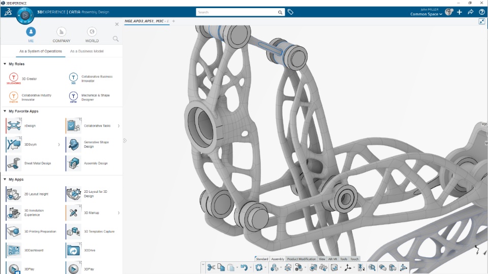

Web & Native (Installed) Apps
This new compass experience is available in Web Apps as well as Native Apps.
NB : in Native apps, the play button is still used in many apps to play available experiences such as simulations.

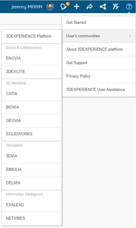

Users Communities
The Access to Brand users communities, previously in the compass, moves to the top bar, in the “help” menu. We also tool this opportunity to provide a direct access to the 3DEXPERIENCE Platform Users Community.
