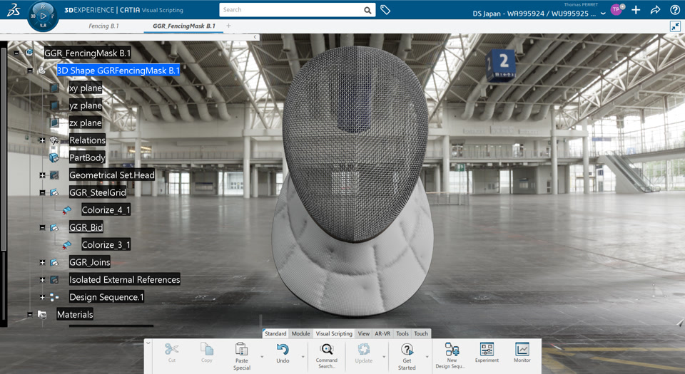

So in celebration of both, I present you a Fencing Mask realized with:
  • Human Design: To have a human reference for the size of the mask and nicer renderings
  • Visual Scripting
    • The algorithmic approach is essential to create easily patterns like for a grill, list manipulation is key.
    • The Soft Body Solver helped me create a more realistic looking padded bib for the mask

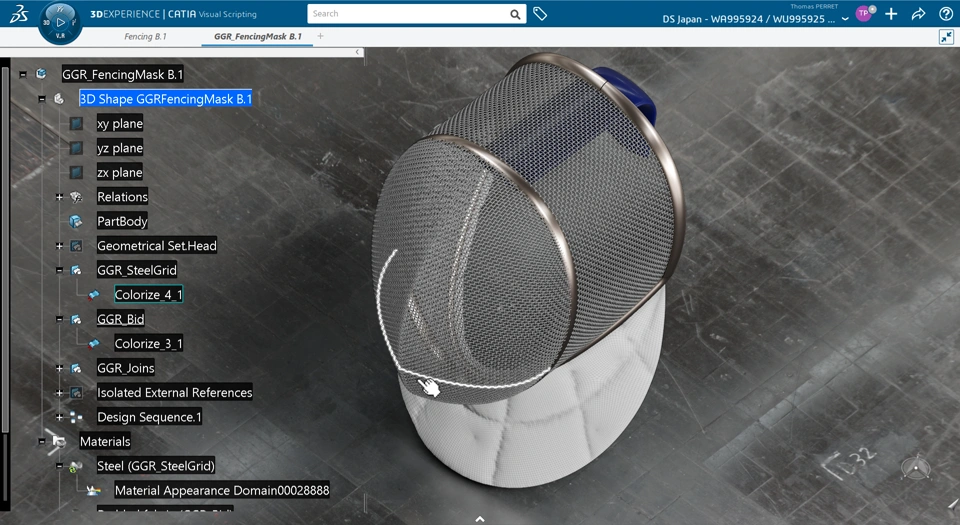

Like in the Weave Pattern tutorial, steel wires are a pattern of splines created by mixing lists of offsetted points. In this case I used the Line Normal operator to translate the points normally to the surface.
