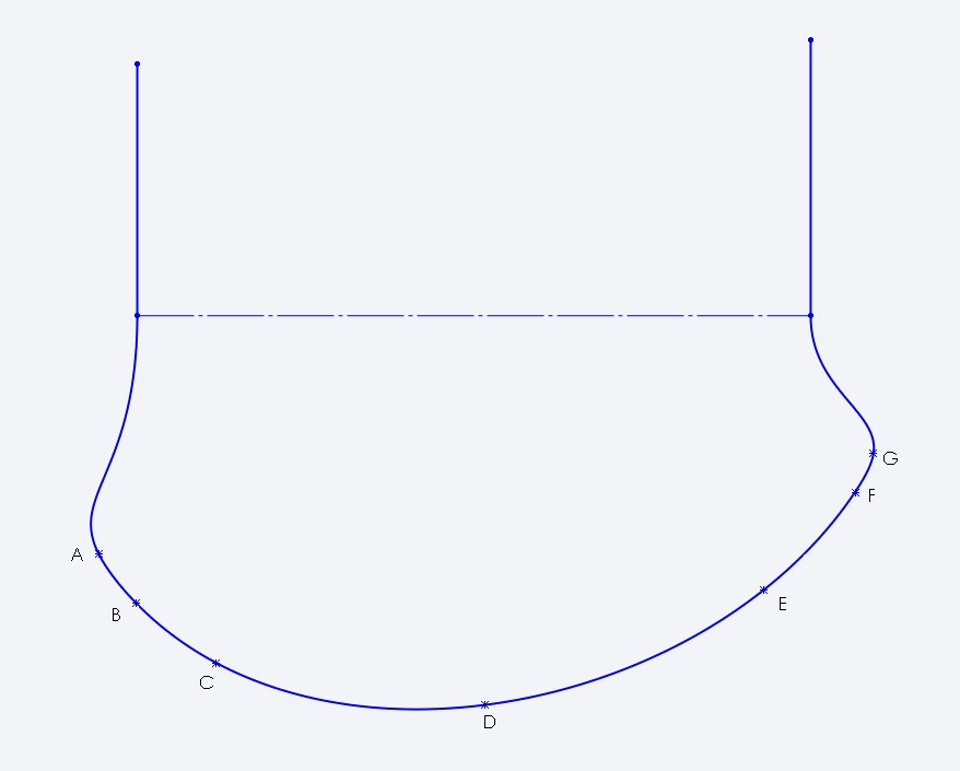

I've got a weird problem. Please see the attached image. Each end of the spline is tangent to a line. If I try to move point A, point B also moves. Usually point B would stay in place and the spline would contour with B acting as a pivot. What the heck is going on? Did I click some weird setting?

If more than 3 points in regular spline this problem is usual. Try Style Spline.
