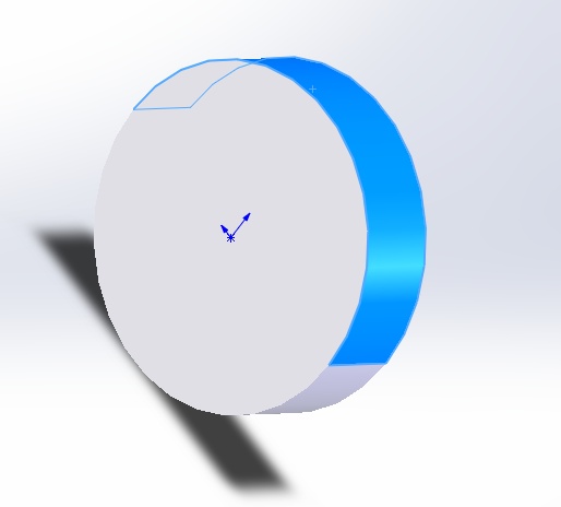

Hi, everybody.
I am in trouble when I export solidworks model as Step file. Cause when I import this step file again, a whole Arc surface is split into two parts which is different from source model. However, I don't come across this case when I use Autodesk Fusion360 software. So, could some one explain it. Should I set some configurations or do some others? The specific case is as follows.

This is not a new idea.... ​ And this is a setting in the export options....​
comment imagecomment image
