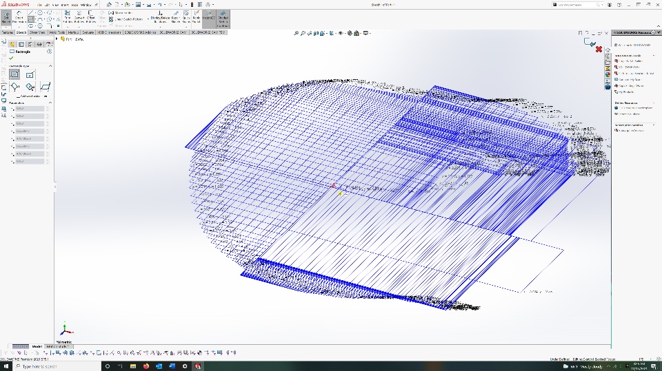

Mr. Zhen commented a solution, turn off "Enhanced Graphics Performance" under settings->performance. Fixed my issue immediately.

In the old configuration, I did not have any issues and was able to use SolidWorks fine. I am getting into rendering for a product and wanted to upgrade my CPU to decrease rendering times/increase performance for my system. With the new configuration, everything works without issue EXCEPT for sketching parts. It looks like the screen is not redrawing, keeping every mouse movement in frame. If you see the attached picture, this is me trying to draw a corner rectangle, which keeps all previous x,y points my cursor went over. I can't find any solutions online, and don't know the appropriate words to describe this behavior. My main goal is to get sketch behavior to how it was in my previous configuration, where I could move the mouse anywhere, and there would only be 1 box on screen.

Turn off enhanced graphic performance and restart your solidworks
https://www.goengineer.com/blog/solidworks-2021-enhanced-graphics-performance
