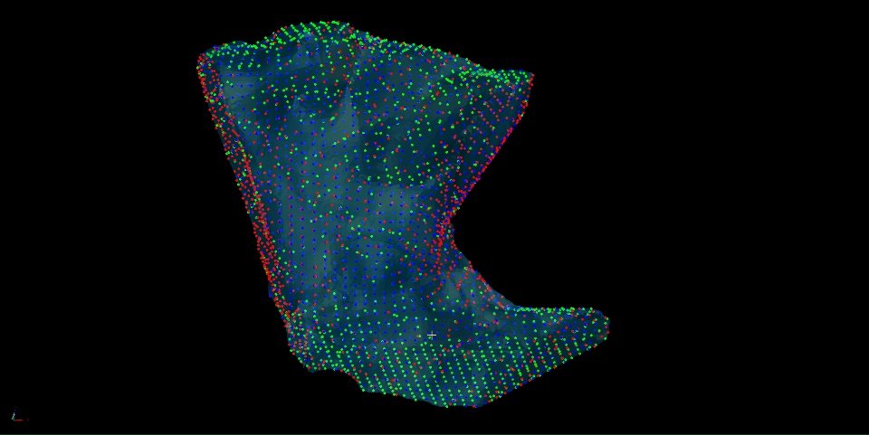

That got me thinking about a different method that could utilize the point cloud functionality. I'll discard my machine-gun / entrance & exit wound analogy and do it like "needling" ... what if you stuck a needle through a balloon and recorded the location of the first and last contact points with the balloon.  If you do that multiple times in multiple directions with a high enough density, you should get a point cloud that could accurately represent the original shape.  It would remove all of the nasty inner triangles and could be refined with Ash's script if needed.

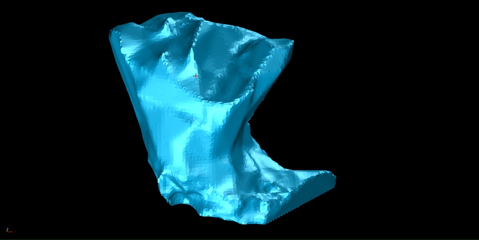

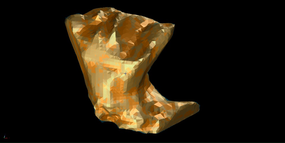

The first image is the original solid (I went simple for the demonstration).  The second image is the point cloud generated by the script overlaid on the original solid.  The colors represent the 3 directions (XZ, XY and YZ planes) that I used to pierce the solid.  The third image is the resulting solid from the point cloud (brown) compared against the original solid.  It runs relatively quickly though it could be improved.  I've run it on multiple problem solids and it seems to do a good job. I've attached the script and a test solid from the images.
