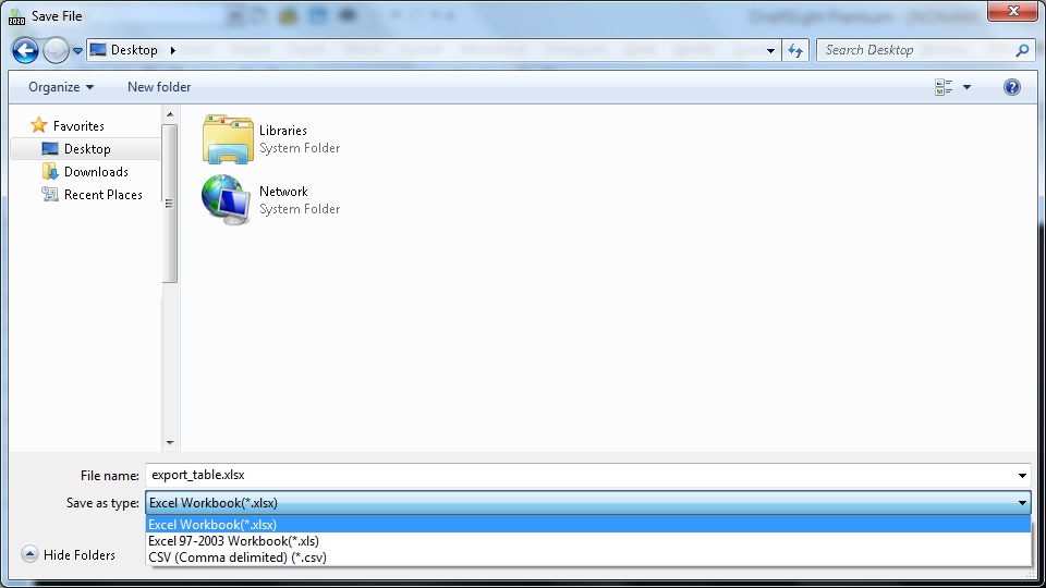

If you have DraftSight tables such as BOM and revisions to export to Excel or CSV files, check out this attached cool dll to automatically export tables. Then the Excel or CSV files can be used where ever you want... imports into ERP system, prints for procurement... Have fun.
Here are simple steps to use it.
1. Unzip the addin ExportTableAddin.dll to a folder C:\\Program Files\\Dassault Systemes\\DraftSight\\bin\\addins
2. Load the addin using LOADAPPLICATION command
3. The add-in command will show up in the "Export" tab
4. Select a table and click on this command to export it.
