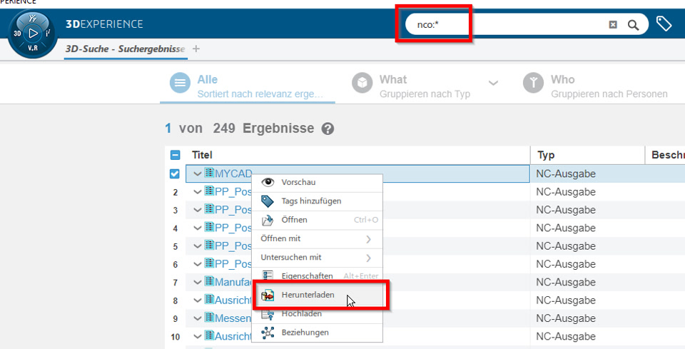

in the rich client you can search for an NC Code nco: and you can download it
and ofcourse you can download it if you open the manufacturing cell

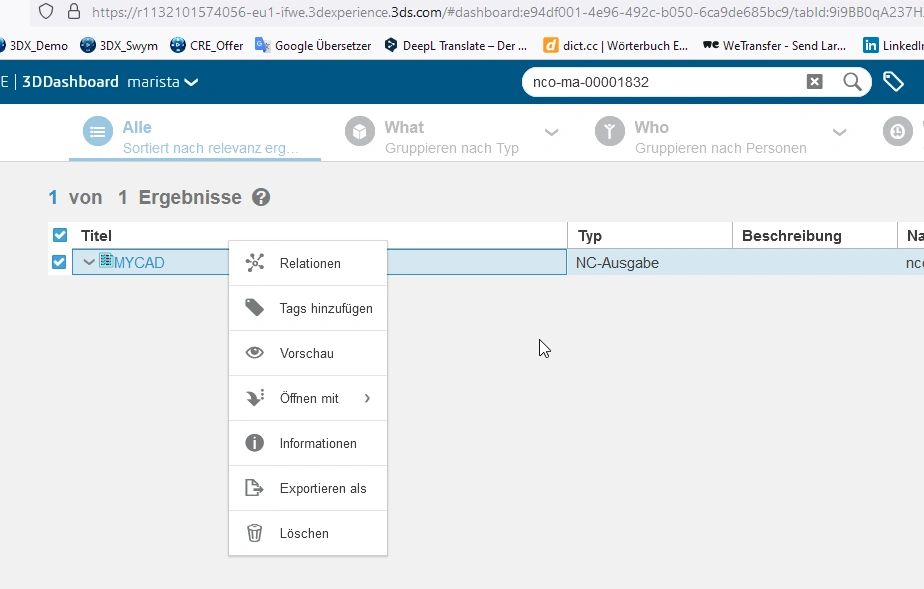

in the web search we have no solution

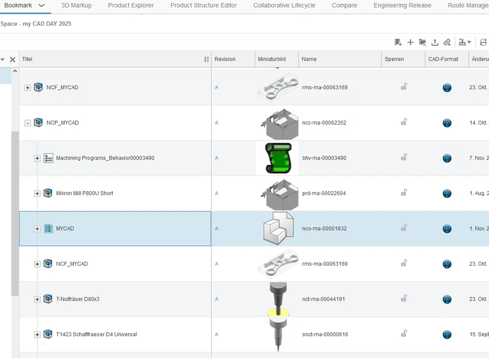

On the object in the Web No solution

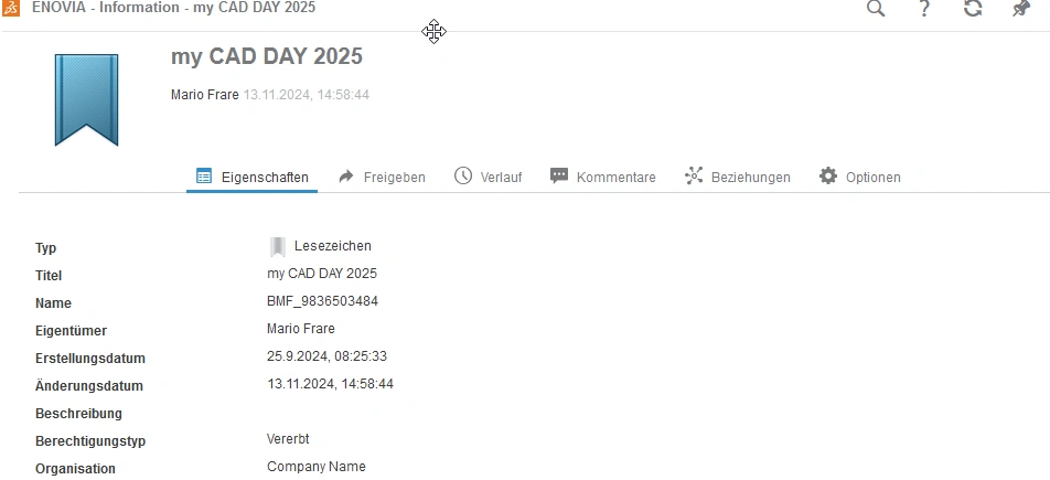

Bookmark no solution
