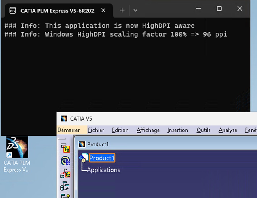

When launching V5 on W11, a black terminal appears.
The V5 -nowindows launch option is not taken into account as in W10.
If this Terminal window is closed, it directly closes V5.

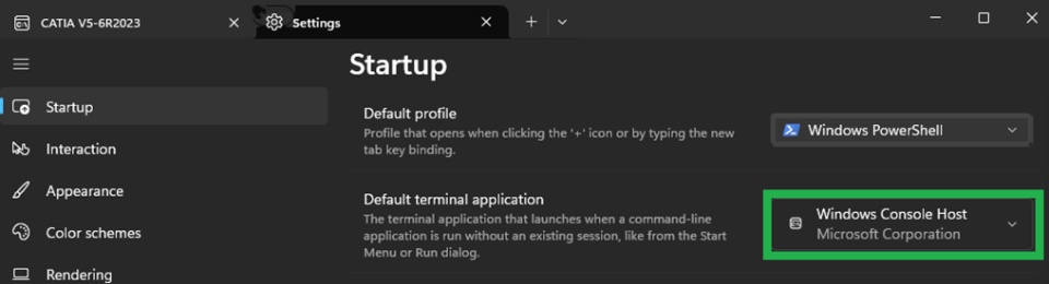

WORKAROUND

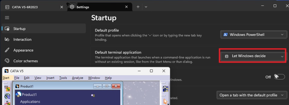

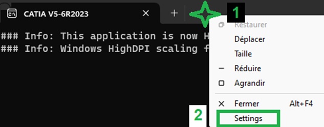

Click on the upper banner of the black window then on Settings
Change the Let Windows decide option and select Windows Console Host
