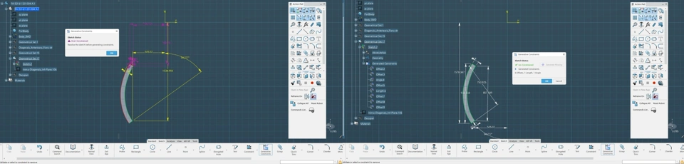

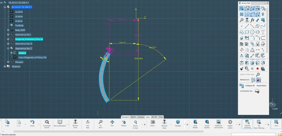

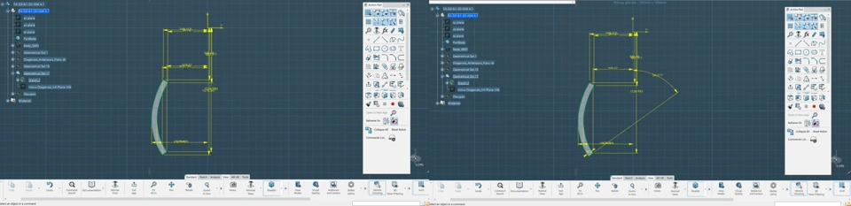

I was curious how it works compared with the command Auto Constraint. For the sketch below, I used the Auto Search to select the profile, and then I selected the H and V axes of the sketch, in both Chained and Stacked modes.
I also tried a macro that I did for CATIA v5 and quickly converted to be used in 3DEXPERIENCE (there were no improvements for the macro). It was even worse; the sketcher had over-constraints.
Using the Generative Constraints command is far better and includes a sketch analysis.
