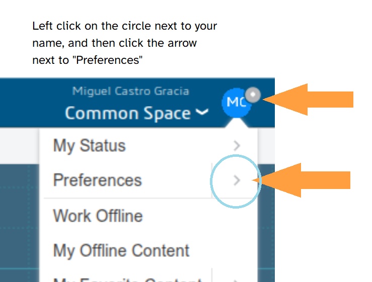

- While on the native apps, left click the circle to the right of your name, and then click the arrow next to "Preferences".

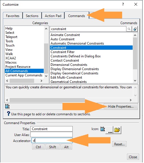

- Click on "Customize", and then go to the "Commands" tab. Here you can see an overview of all the commands in the platform.
- You can now go to either the "All commands" or the "Current app commands" category, and search for the command to which you want to assign a keybind.
- Click on the "Properties" button, and write your keybind on the "Accelerator" section. You can make shortcuts with both SHIFT and CTRL. When you are done, close the window and the shortcuts will work!
