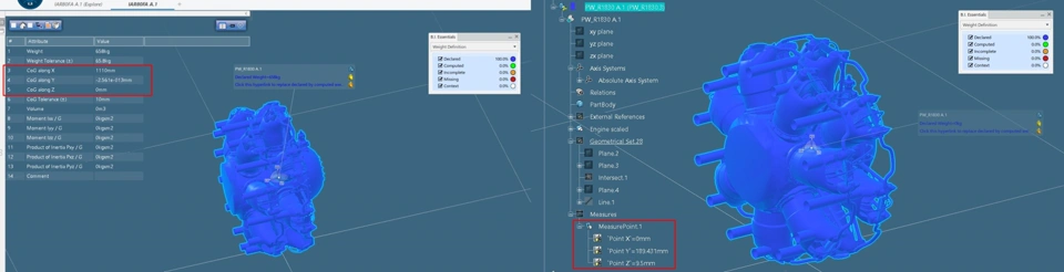

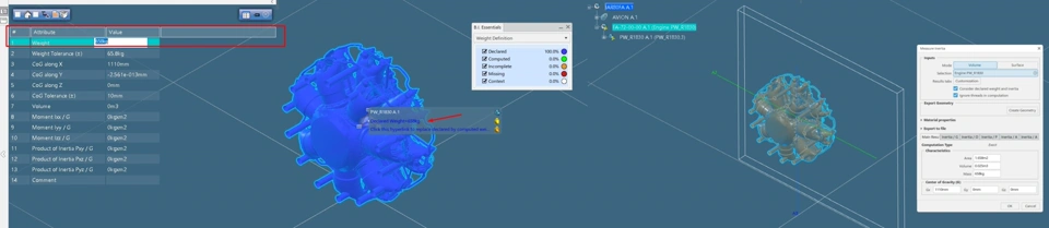

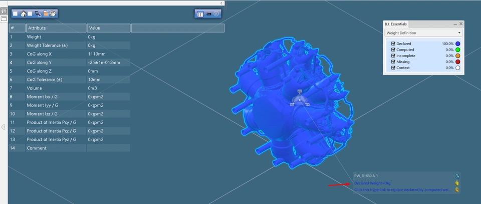

This will be done using B.I.Essentials tool to declare the weight.
You can easily edit the immersive table; the changes will be automatically updated in the Measure Inertia tool. Just make sure to check the 'Consider declared weights and inertia' option
You may also choose to enter a pre-measured center of gravity, as we did. By default, the software calculates this based on your settings. To adjust the CoG coordinates, you can follow the same steps used for modifying the mass.
