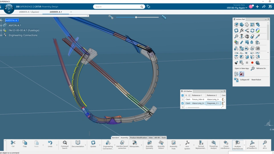

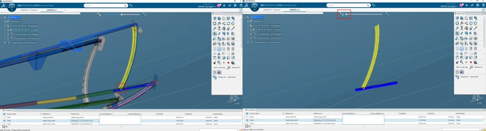

CATIA 3DEXPERIENCE offers several unique features not found in CATIA v5. For instance, in the images below, the left side displays a list of interferences filtered by clash at the bottom. In contrast, the right side provides an option to adjust the transparency of the entire assembly, making it easy to identify which parts are involved in the clash.

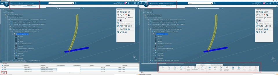

While keeping the interference window active, you can seamlessly switch to any application needed to resolve the issue. If necessary, the window can be easily hidden by clicking the icons in the left corner, as shown on the right side of the image.

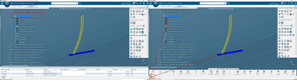

In the same way, you can switch to ENOVIA apps to use any command you need (for example, change owner).
The interference window is fully adjustable, allowing you to position it wherever you prefer, as illustrated in the image below
