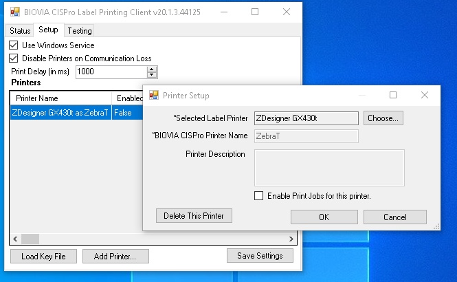

Remove from Print Client
  • Open the BIOVIA CISPro Label Printing Client and go to the Setup Tab
  • Double Click the printer to be removed.
  • When the Printer Setup details open, select “Delete This Printer” > OK > Save Settings

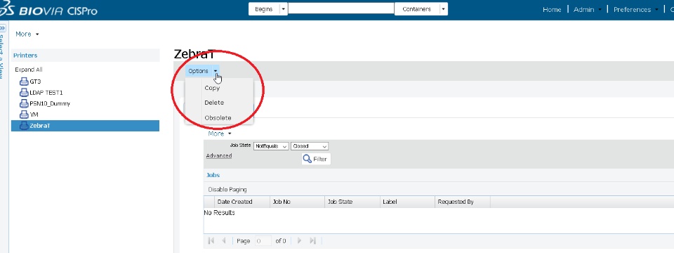

Remove from CISPro Web Application:
  • Log into CISPro and from Select a View menu, click System > Printers.
  • Click on the Name of the Printer you wish to delete and under Options > Delete
