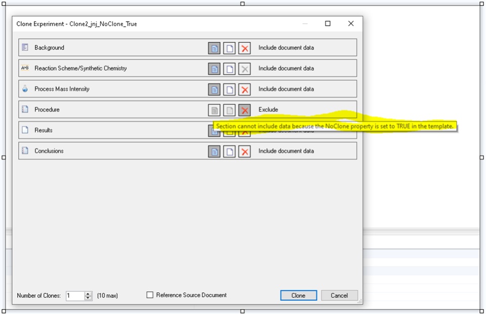

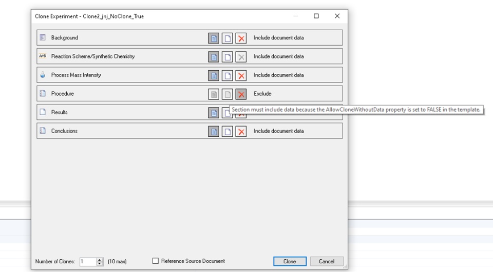

How to control Workbook Experiment section Data during Cloning Process
Often Workbook end users clone experiments from their own or from other users to reuse existing experiment format but they do not want to create with other experiment's data. To achieve this Workbook templates can be configured with section properties as below.
  1. AllowCloneWithoutData :- False – Meaning the “Exclude Document Data” button will be greyed out.
  1. No Clone – True – Meaning during Coning Process the Include Document Data menu option is greyed out and section will not include data.
With the above settings Clone or QuickClone will not bring in the section data further to new experiment.
