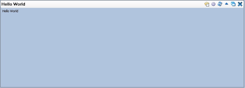

Modify the appearance of the control as you like in the designer. Mine just has a label with the text "Hello World":

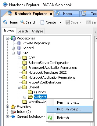

Log in to the Workbook server using the Workbook client.
Navigate to the "Site\\Shared\\Widgets" folder in "Notebook Explorer".
Click "Publish vozip..." from the context menu.
Select the "HelloWorldWidget.vozip" file you created previously, and click the "Open" button. This will upload the package to the server.

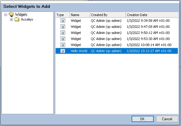

Add widget
You can now open the HomePage tab and add the widget:
Select the "Hello World" widget, and click the "OK" button.
