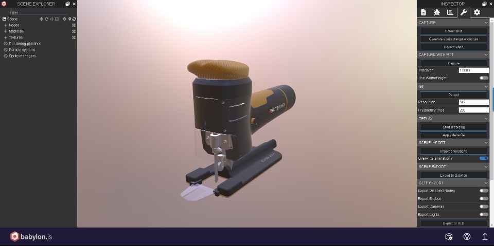

Yeah, it'd be ideal to use it everywhere, so that we wouldn't have to bother with this nerdy term at all. The challenge is that not all 3D glTF viewers support KTX2 yet. So when you you are hosting glTF, it'd be wise to verify the viewer first.
The babylon viewer and the Khronos sample viewer both handle KTX2 well.
The former works well with geometry compression too.
