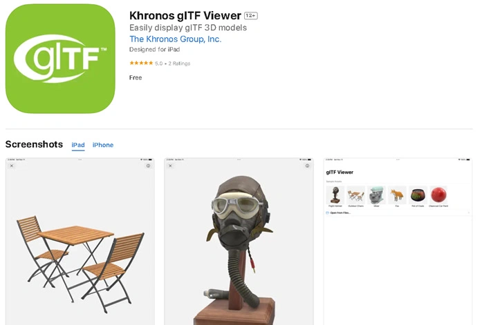

  2. Open this glb on your phone with a mobile glTF Viewer, such as this one by the Khronos Group.
  3. On the App, switch to the AR tab and scan a flat surface, such as the chessboard. Now your favorite digital chess piece is in the physical space.
