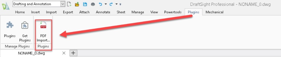

3. Check under plugins menu:
After installation PDF Import will be available under the Plugins menu. (Make sure to enable PDF Import Neo from add-ins list if plugins menu is not visible)
