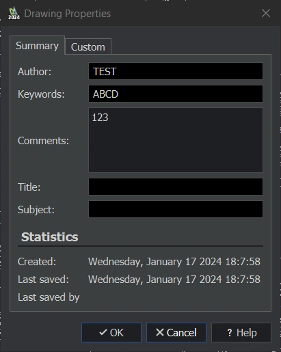

There is a list of properties associated with .dwg file under File>Properties or there is an attributes information added for blocks in drawing file. DraftSight properties and 3DEXPERIENCE attributes both are used to store all kinds of useful information for files including, descriptions, part numbers, revisions etc..
                               File Properties                                                      Custom Properties

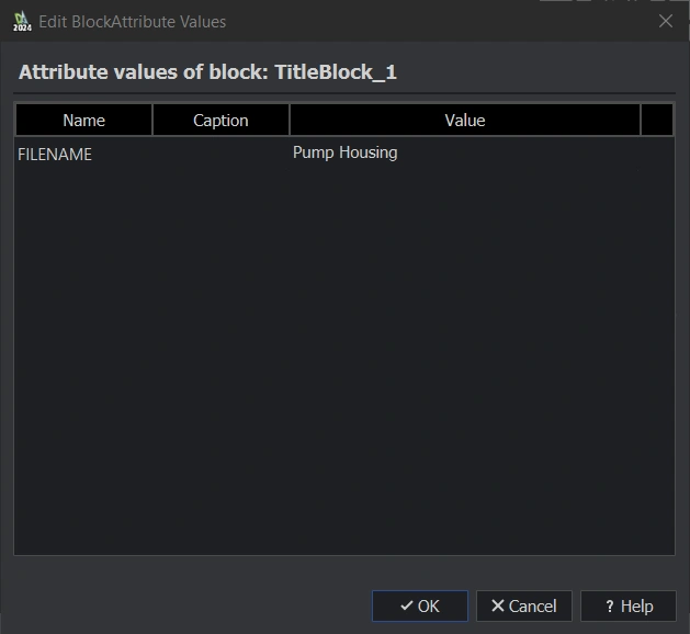

                           Block attributes

File Properties\\\$\\\$attribute names\\\$\\\$\\\$\\\$Author\\\$\\\$

Block Propertiesblock name:ATTRIBUTE NAMEBlock:TITLE

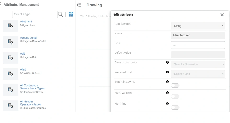

  1. Launch 3DEXPERIENCE Platform click on 3Dashboard and from list of dashbaords go to Platform Management>Content>Collaborative Spaces Configuration Center
  2. Go to Attribute management>Drawing
  3. Click on Add Attribute. Specify Name of attribute to e.g. Manufacturer
            You can keep default value as empty . Click apply to deploy the attribute.

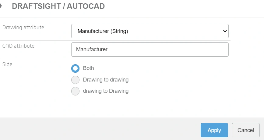

  1. Lastly map the attributes to Draftsight for this go to Collaborative spaces control center >CAD Collaboration>DraftSight\\AutoCAD using appropriate syntaxes (Image1)
  • Both: Bi-directional Mapping
  • Drawing to drawing: Platform to DraftSight mapping
  • drawing to Drawing : DraftSight to Platform mapping

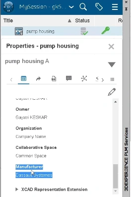

  1. Save the .dwg file on a platform from DraftSight MySession widget and you will see Property values are updated from drawing to Platform and vice versa as below:
It is very useful to map DraftSight properties to their related 3DEXPERIENCE attributes, this means we only need to input information in one place which is time saving and avoiding the risk of information going out of sync.
