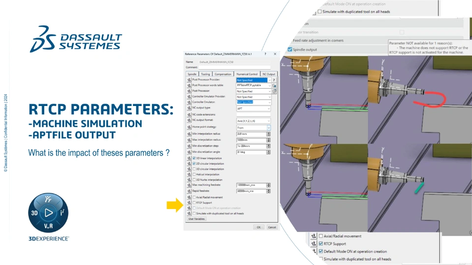

When you define a  5 axis milling machine you can set two RTCP parameters in the “Numerical Control” section (via: “NC Resources/Modify Nc Resources”)
  • RTCP Support
  • Default Mode ON at operation creation (if the previous  RTCP Support is activated)
Default is OFF
Theses parameters impact the machine toolpath simulation and also the APTfile output.
I propose in the following pdf to summarize the behavior and the impact.

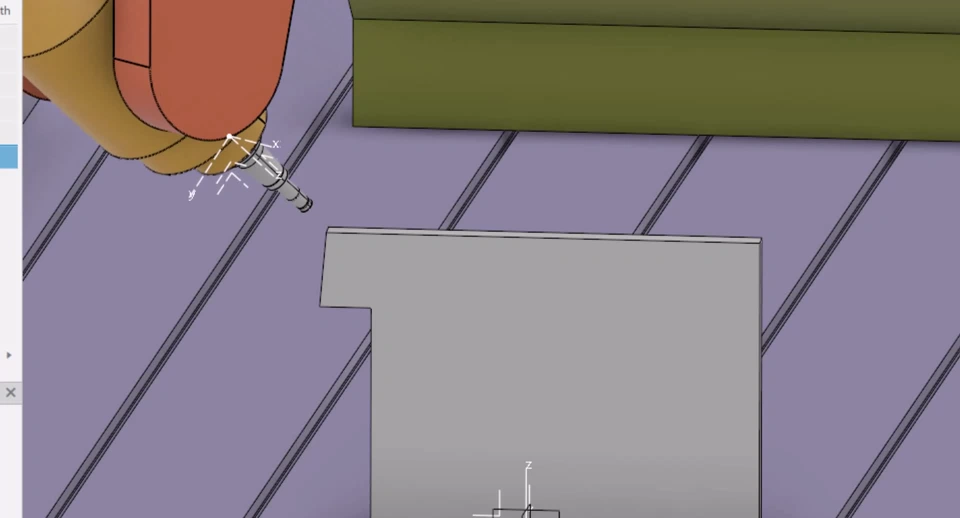

and also two short videos with and vithout RTCP during the transition path machine simulation
