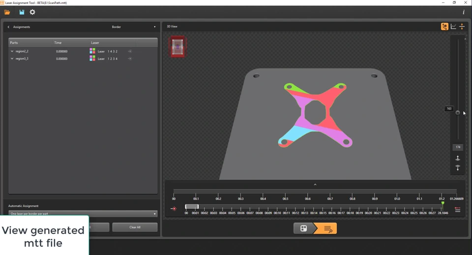

12/ To click "Display" button to review the trajectories from Renishaw APIs.
12/ To open "Generate output" command then to select either "mtt" or "RenAM" file format
13/ To click on Generate.
15/ To open generated file in QuantAM.
16/ To review job file then to send it for manufacturing.

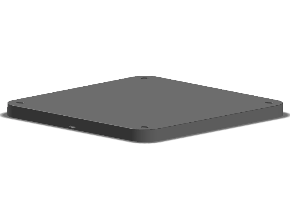

Available models
The model representing build substrate for the below additive machines:
Build substrate 250x250
Build substrate model
Tip: To download the model, click on chevron icon located at the top right corner of the image.
