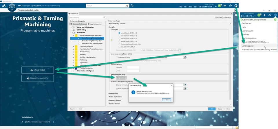

In the Machining landing page (displayed when yu load app the first time or can be reload via ? ) you have a ‘check install' to control the instalation

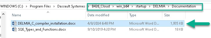

if the compiler is not installed on your machine , a documentation is available in the instal path to help you
