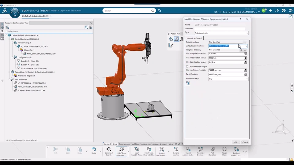

Machining or Additive with a Robot. Which output format ?
In the Fabrication domain (Machining or Additive) you can generate Robot output or NC output (APTfile or Gcode with a Postprocessor).
The choice has to be done in the workcell (see video).
The best way to work is to define a "Start Manufacturing Cell" and use it after to generate a new one.
