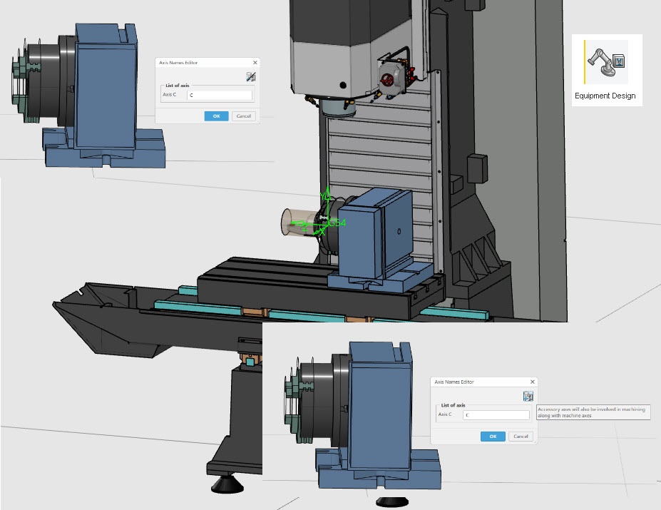

How to merge accessory and machine kinematics ?
Before (and by default now) the axis position of the accessory has to be managed with Machine Instruction (locked) to do 4 axis positioning
Now you can define the accessory axis as “merged with machine kinematics” and Machine instruction are no more mandatory ...and you can also mill in 4 axis continuous
A small button, but a huge improvement to improve the resources definition ! and to be more and more closed to the digital twin
