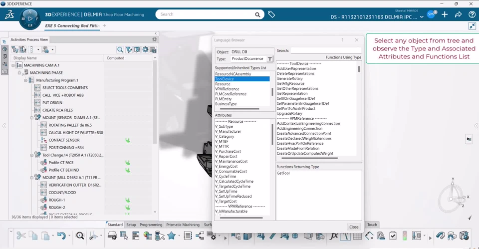

To start writing any EKL (Enterprise Knowledge Language) Script, we first need to understand the Object Types available in this language and the attributes and functions available on those types. This document is intended to provide the detailed guide on how to access this information in 3DExperience Platform using Language Browser.
Detailed Explanation
Language Browser allows you to browse the EKL language types and functions and gives information on the selected objects EKL exposition. Below video demonstrates how the language browser can be used to get the required information.
