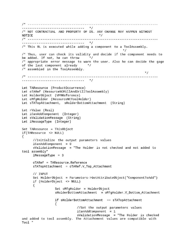

While adding holder component in tool assembly, we can perform some checks to determine the compatibility of component to be added(holder) with existing tool/holder component in tool assembly using given business rule.
One example of a check could be Attachment compatibility between Holder to be added and the existing Tool/Holder in Tool Assembly.
Following script explains the checks that can be implemented.
Fetch Inputs and Initialize the output parameter values
Set TAResource = ThisObject
if(TAResource <> NULL)
//Initialize the output parameters values
iCanAddComponent = 0
sValidationMessage = "The Holder is not checked and not added to tool assembly"
iMessageType = 3
oTARef = TAResource.Reference
sTATopAttachment = oTARef.V_Top_Attachment
// INPUT
Set HolderObject = Parameters->GetAttributeObject("ComponentToAdd")Implement the Check. Here we are checking whether the bottom attachment type on holder is same as the top attachment type for tool assembly which is propagated from attachment type on topmost tool/holder component in tool assembly.
if (HolderObject <> NULL)
Set oMfgHolder = HolderObject
sHolderBottomAttachment = oMfgHolder.V_Bottom_Attachment
if sHolderBottomAttachment == sTATopAttachment
//Set the output parameters values
iCanAddComponent = 1
sValidationMessage = "The Holder is checked and added to tool assembly. The Attachement values are compatible with Tool "
iMessageType = 1
else
sValidationMessage = "The Holder is checked and not added to tool assembly. The Attachement values are not compatible with Tool "
iMessageType = 3
}Set Output
//OUTPUT
Parameters.SetAttributeInteger("CanAddComponent", iCanAddComponent)
Parameters.SetAttributeString("ValidationMessage",sValidationMessage)
Parameters.SetAttributeReal ("GageValueOfExistingComp", rValue) //Currentlt Value is not set, if value needed to be set add rValue = 30.0 in initiaization section
Parameters.SetAttributeInteger ("MessageType", iMessageType)Parameter Output details:
- CanAddComponent-> Whether to add component or not
- Value 0 -> The component is not added to tool assembly
- Value 1 -> The component is added to tool assembly, provided subsequent checks like attachment type etc. compatibility succeeds
- Value 2 -> user wants to bypass the subsequent checks and force add the component to tool assembly
- ValidationMessage-> Message in this output parameter will be displayed in “Messages Reporting” panel. This could be an empty string, if user is not interested to display any message in “Message Reporting” panel.
- GageValueOfExistingComp-> This output parameter holds a double value and it sets the gage value of the existing component (Topmost) in Tool Assembly, on which “ComponentToAdd” will be mounted. If no value is defined, then the nominal gage of the existing topmost component will be used to position the “ComponentToAdd”.
- MessageType-> Type of the message. Its value can be 1, 2, 3. If value is set to 1, then the message type is "Information", if value is set to 2, then the message type is "Warning" and if the value is set to 3, then the message type is "Error"
