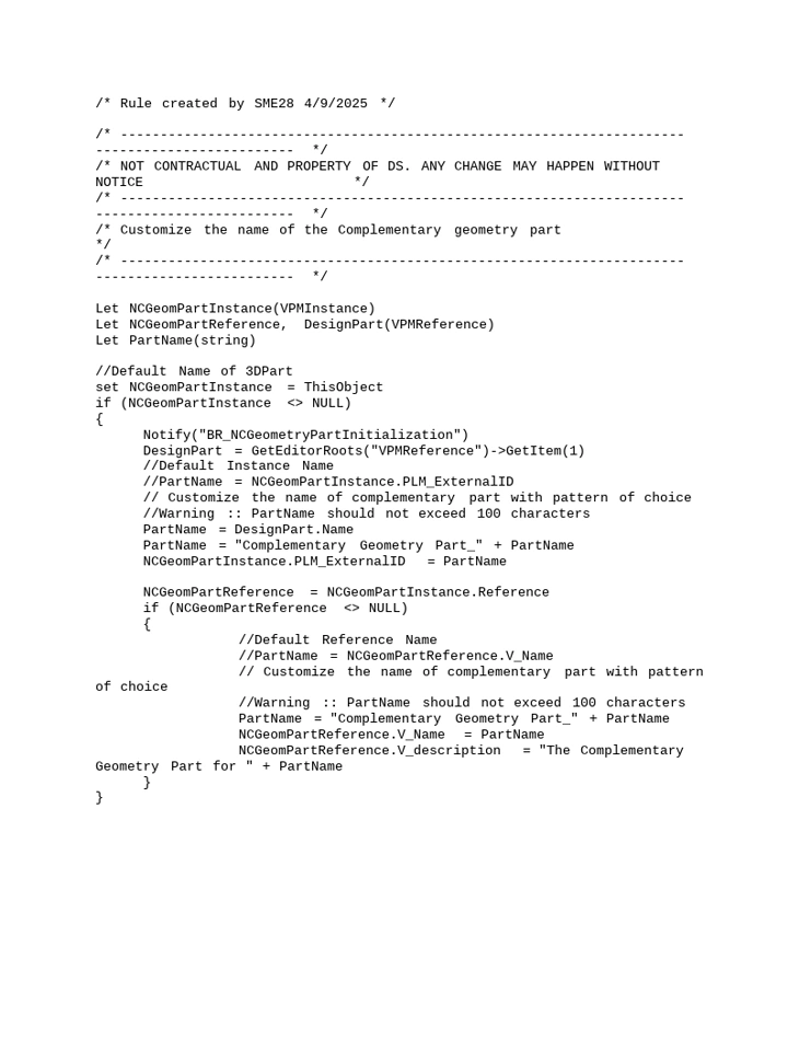

DELNCGeometryPart.CATRule
Detail Explanation
Using business rule for NC Geometry Part Initialization, we can automatically setup the Reference Name, Instance name and descriptions of Complementary Geometry Parts (NC geometry Part) at the time of its creation.
Complementary Geometry Part is basically a physical product created to store any geometries that are input for the definition of part operation and machining operations.
In given sample code, we are defining the naming convention of complementary geometry part as "Complementary Geometry Part_" + Name of the Design Part for which we have created the Manufacturing Product and the complementary geometry part.
So, first we are fetching the design part and getting it name. Then we are setting the instance name of the Complementary Geometry Part with specific prefix addition.
//Default Name of 3DPart
set NCGeomPartInstance = ThisObject
if (NCGeomPartInstance <> NULL)
	Notify("BR_NCGeometryPartInitialization")
	DesignPart = GetEditorRoots("VPMReference")->GetItem(1)
	//Default Instance Name
	//PartName = NCGeomPartInstance.PLM_ExternalID
	// Customize the name of complementary part with pattern of choice
	//Warning :: PartName should not exceed 100 characters
	PartName = DesignPart.Name
	PartName = "Complementary Geometry Part_" + PartName
	NCGeomPartInstance.PLM_ExternalID = PartName
Then, we can also access the reference of the part created and set its name.
NCGeomPartReference = NCGeomPartInstance.Reference
	if (NCGeomPartReference <> NULL)
		//Default Reference Name
		//PartName = NCGeomPartReference.V_Name
		NCGeomPartReference.V_Name = PartName
		NCGeomPartReference.V_description = "The Complementary Geometry Part for " + PartName
Important Note: Prerequisite for this business rule is the preference setting as shown in demo video. This Business Rule gets executed only if the Complementary Geometry Part is created automatically as demonstrated in video. If user creates the part manually, the business rule will not be executed.
Business Rule Setup
Business Rule opening Id - DELNCGeometryPart_ID
The Business Rule can be executed in two different ways.
  1. DataSetup App: If you create the script through DataSetup, it remains persistent in the database, is stored on the server and available to all. The script opening ID will be available under Machining Resources.
  2. CATRule/CATRuleExit: If you create the script using a CATRule, you must store the files DELNCGeometryPart.CATRule and DELNCGeometryPart.CATRuleExit in ..\\resources\\knowledge\\scripts. You can then edit the CATRule file or create a new CATRule and CATRuleExit files with an Opening ID of DELNCGeometryPart_ID
    Note: Be careful while using this method as the setup is done on local machine and it is not available to all users. Each user will have to do the setup individually.
