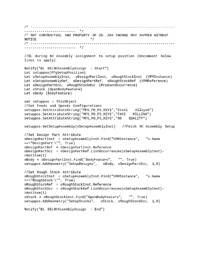

Using Business Rule for NC Assembly Assignment, we can accelerate the setup position creation process in case of part operation having Multi-Setup Positions definition. The business rule is executed during the NC Assembly assignment to setup position. The user can use this to initialize the setup position's attributes such as Rough Stock, Design Part, Fixtures, Feeds and Speeds Configuration.
Following script will explain how to initialize the attribute values using business rule.
Fetch Input object and set Feeds and Speeds configuration attributes. The input object type is "MfgSetupPosition".
set setuppos = ThisObject
//Set Feeds and Speeds Configurations
setuppos.SetAttributeString("MFG_PO_FS_KEY1","Steel Alloyed")
setuppos.SetAttributeString("MFG_PO_FS_KEY2","FACE MILLING")
setuppos.SetAttributeString("MFG_PO_FS_KEY3","NO QUALITY")
Fetch the assigned NC Assembly Setup.
setuppos.GetSetupAssembly(oSetupAssemblyInst) //Fetch NC Assembly Setup
Set Design Part Attribute.
//Set Design Part Attribute
oDesignPartInst = oSetupAssemblyInst.Find("VPMInstance", "x.Name ==\\"DesignPart\\"", True)
oDesignPartRef = oDesignPartInst.Reference
oDesignPartOcc = oDesignPartRef.ListOccurrences(oSetupAssemblyInst)->GetItem(1)
oBody = oDesignPartInst.Find("BodyFeature", "", True)
setuppos.AddGeometry("SetupDesigns", oBody, oDesignPartOcc, 1,0)
Set Stock Part Attribute.
//Set Rough Stock Attribute
oRoughStockInst = oSetupAssemblyInst.Find("VPMInstance", "x.Name ==\\"RoughStock\\"", True)
oRoughStockRef = oRoughStockInst.Reference
oRoughStockOcc = oRoughStockRef.ListOccurrences(oSetupAssemblyInst)->GetItem(1)
oStock = oRoughStockInst.Find("OpenBodyFeature", "", True)
setuppos.AddGeometry("SetupStocks", oStock, oRoughStockOcc, 1,0)
