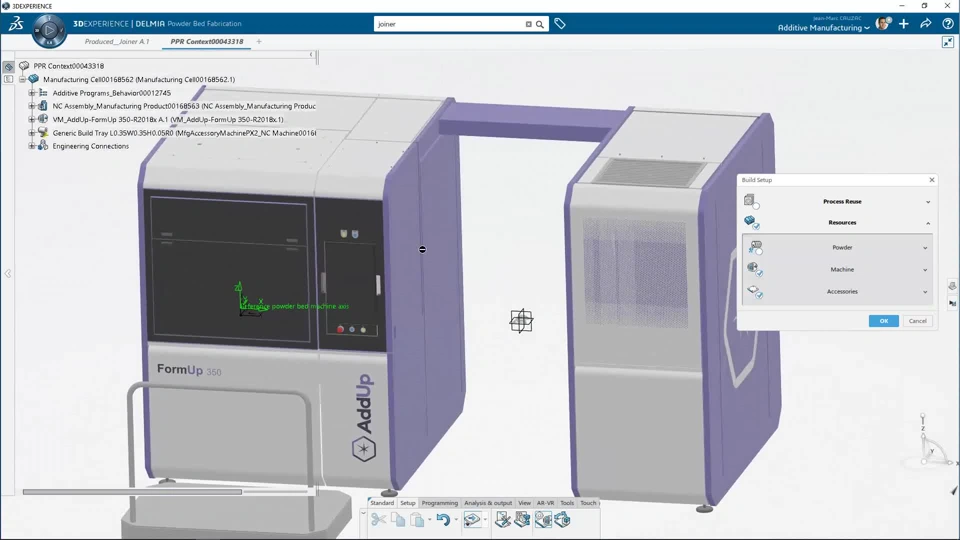

This video guides you from verifying model consistency to generating job file for your FormUp printer.
To be noticed, workflow is the same for all published models.
1/ To launch 3DEXPERIENCE.
2/ To download your Additive Machine model then to import the 3DXML file into 3DEXPERIENCE.
3/ To start your Additive application.
4/ To open "Search Machine" command then to pick the uploaded model.
5/ To open PLM tree and to left-click on it. To click on "edit machine" button from the bubble bar. Or, you can right-click on it then inside the contextual menu, go to Additive Machine then click on Edit NC Resource
6/ To check that "AddUp_TemplateFileName" custom parameter is defined:
     AddUp_TemplateFileName parameter must point to the template.addproj file and blank spaces inside the filename are not supported.
7/ To open "Virtual Machine" expander, to click on "Check library load":
          To verify that following services are checked: "Get list of available rules" ; "Create jobfile from geometry" ; "Get Settings"
8/ To open "Rules" expander, to click on "Update list of rules". To check that Rules are added under both "Build process" & "Scan path" nodes
9/ To prepare the build...
... Once you are about to define scanning strategy:
10/ To open "Generate output" command then to check that "addproj" option appears inside the "Format" dropdown list.
11/ To click on "Build strategy" button.
12/ To pick one from dropdown list next to Build process rule then to define Scan path rule on all regions.
            To validate assignment.
13/ To click on Generate.
14/ To open "Display scan path" command to review the trajectories coming from AddUp APIs.
15/ To open generated addproj file in AddUp Manager.
16/ To review job file then to send it for manufacturing.
